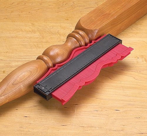

Where would i find one of those countour guides? I think I have seen something like that ... it basically holds the shape of the curve so you can trace it out.?>?>>?.. I am assuming. What else would it be called or where can I get one? OHH I located a source for the dolphin glaze locally. They have it at a body shop supply company.

................Where would i find one of those countour guides?
Probably get on at an Ace or True Value hardware store. They are sometimes called "copy cats" also.

Better yet, here's a pic and a web site.
Randy

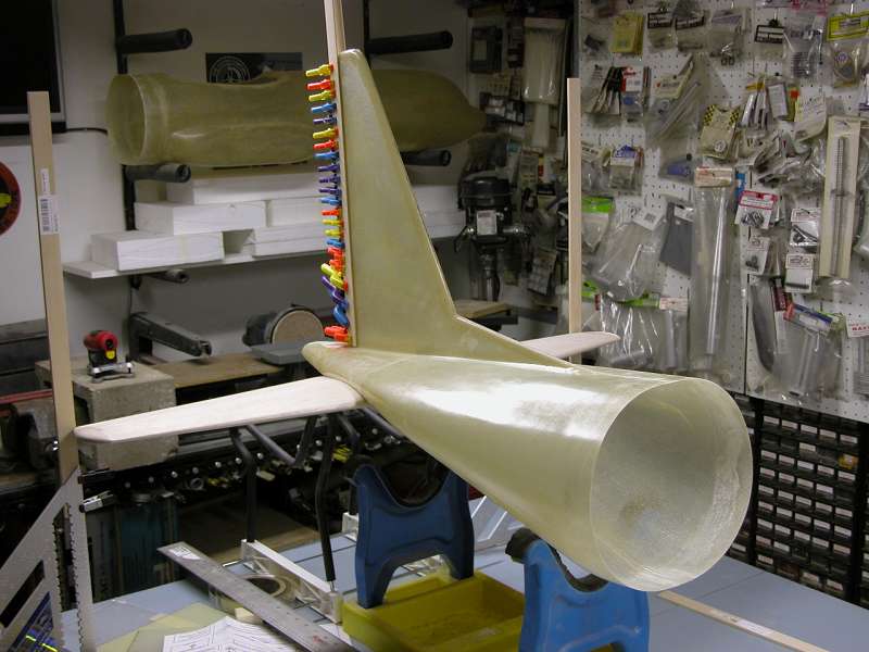

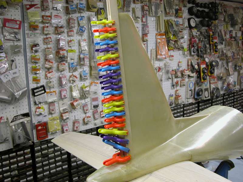

Progress report.
Pic. 1 - Rudder post with tork rod.
Pic. 2 - Gluing rudder post in and aligning with laser.
Pic. 3 - Once aligned, full set of clamps and a pair of wood strips on the outside to evenly clamp it inside the fin.
Pic. 4 - Looks good, but you should always at least double check your work with a ruler or tape measure. I checked stab tip to fin tip (compare to other side and should be right on) both diagonally and horizontally.
Gunny

VERY COOL IDEA!!!!! That torgue rod is a great idea!!!! Previously I was goig to do a standard horn or pull pull system. VERY COOL IDEA!!!!

I did a pull pull with the 120 oz servo mounted inside the vertical stab. Only the tips of the servo arms excend out of the stab. I used 120 oz due to the possibility of engine out, which has happened. Make sure your servo is large enough for the engine out possibility. On the real herk,, we could pull the flap control CB and move the flaps lever to greater than 20%, this would give 3000 psi rudder boost vs the 1250 normally used. So the rudder is a big deal if you lose an engine,, on the model and 1:1 size. Jim

I did the exact same thing already by putting in a torque rod and install a servo inverted on the bottom of the vertical stab. All linkages are totally concealed. You could almost do the same thing for the elevators too.
I'm pretty much on hold right now waiting for the wing tubes so I can finish the wings. Everything else is pretty much done so I have started with the primer and putty on the fuse. It is pretty much going faster then I thought it would and when I finish the fiberglassing the wings its all downhill from there.
