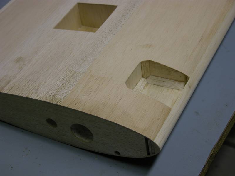

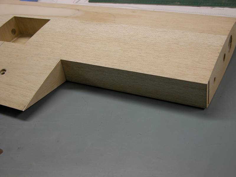

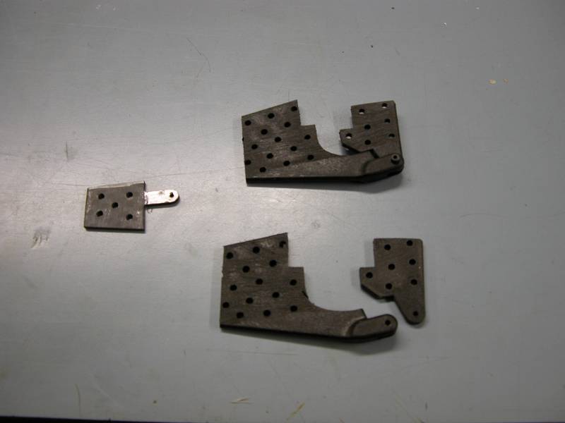

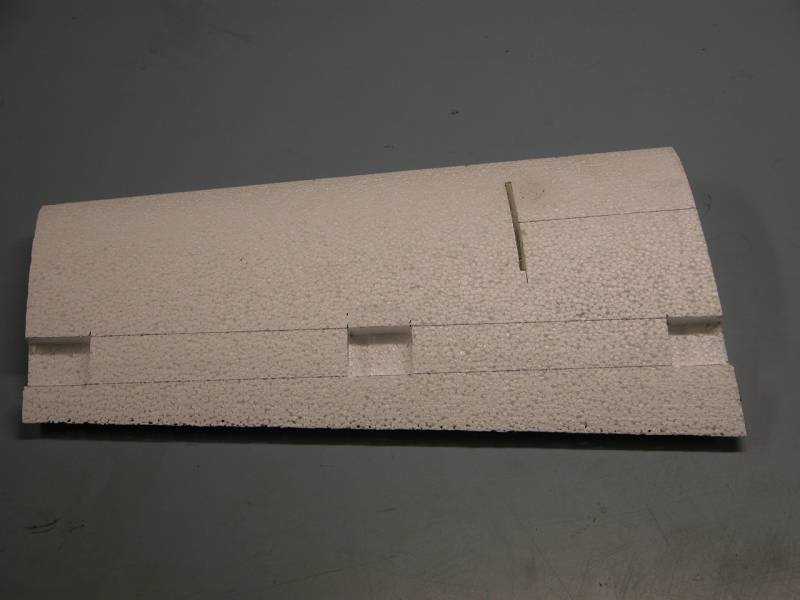

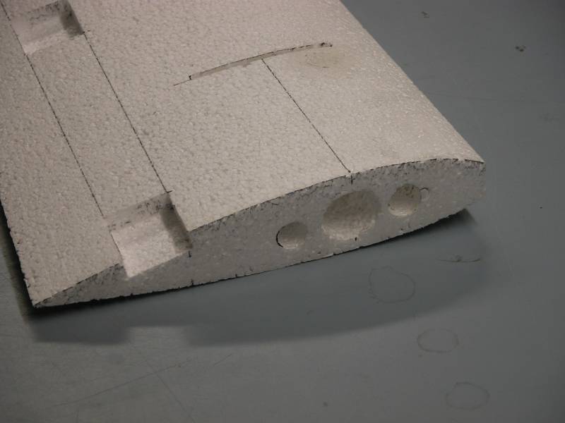

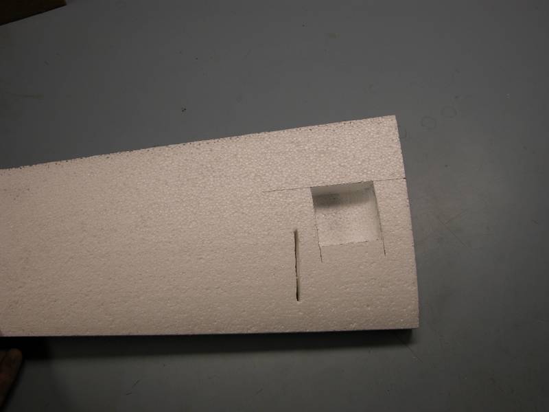

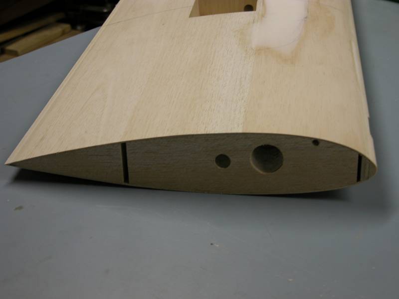

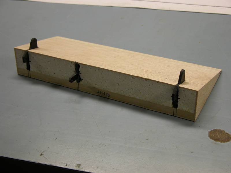

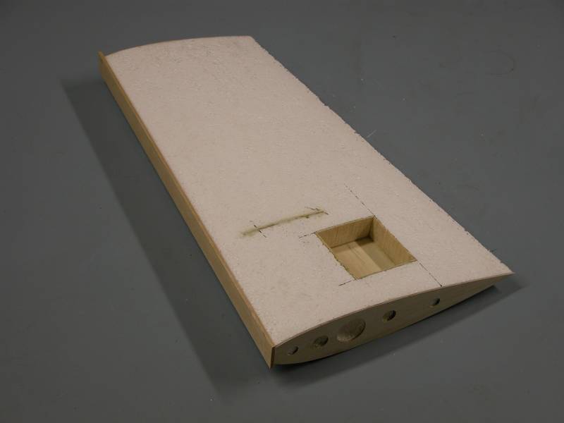

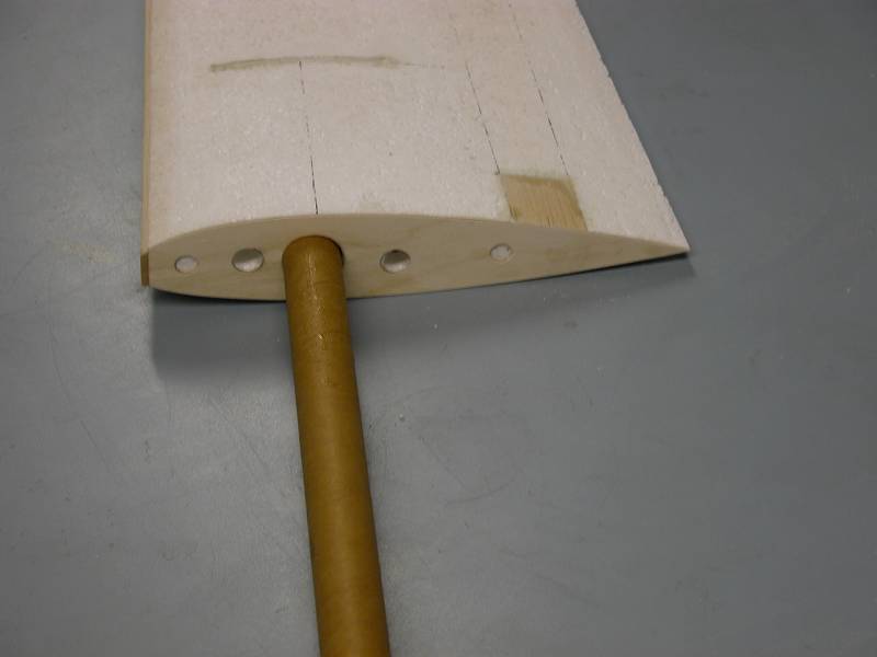

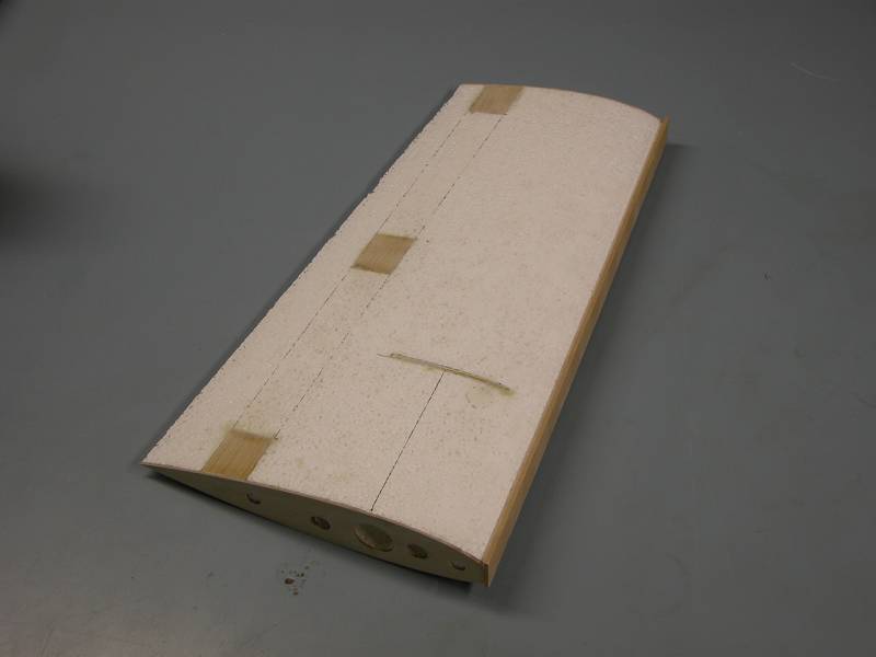

O.k. back to more progress. Here is the outer wing tip section.
Pic 1. & 2. shows the cut out for the hinge blocks and the long thin slot is the wing tube termination rib cut out. Also shown is the wing tube hole and the 1/2" dia. holes for the ail. servo plug "rear" and the nav light plug "front" of the wing tube hole.
Pic. 3 shows the ail servo bay cut out.
Gunny

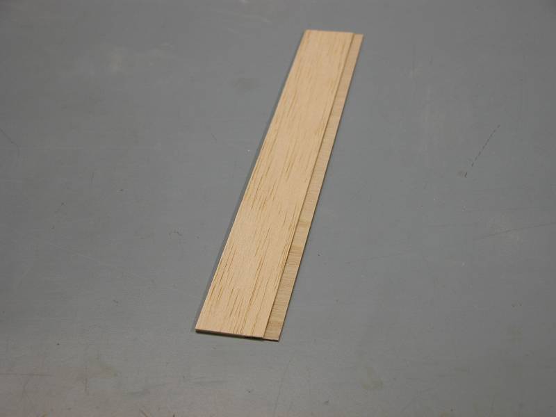

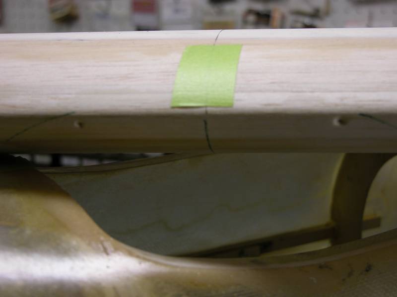

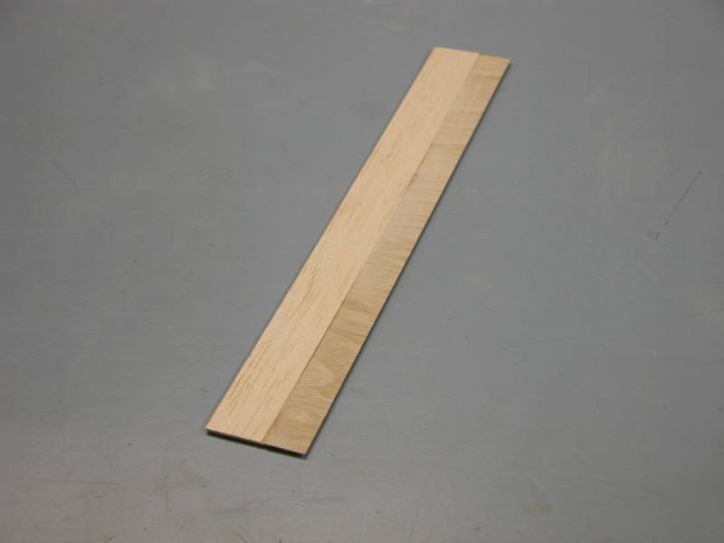

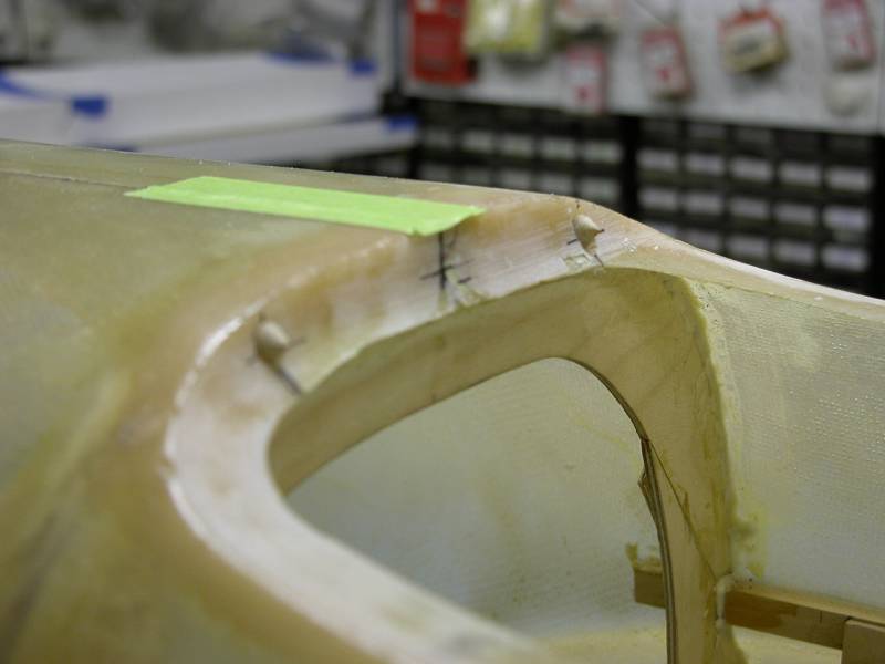

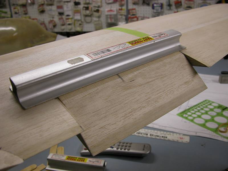

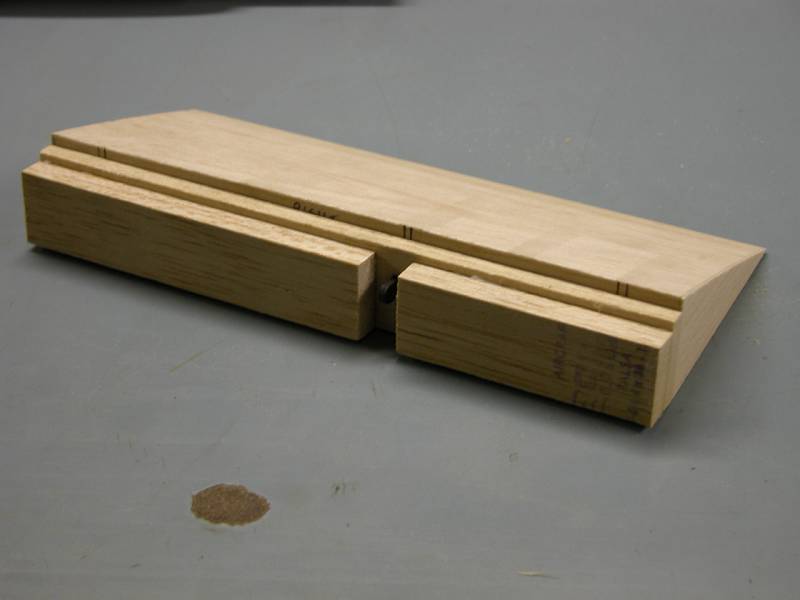

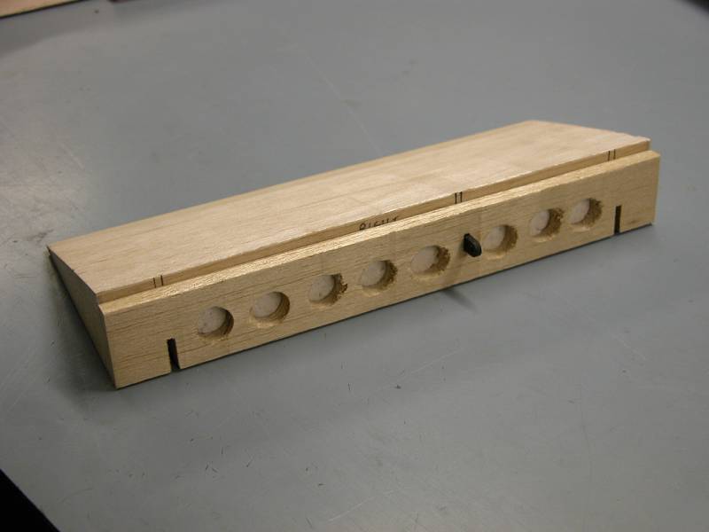

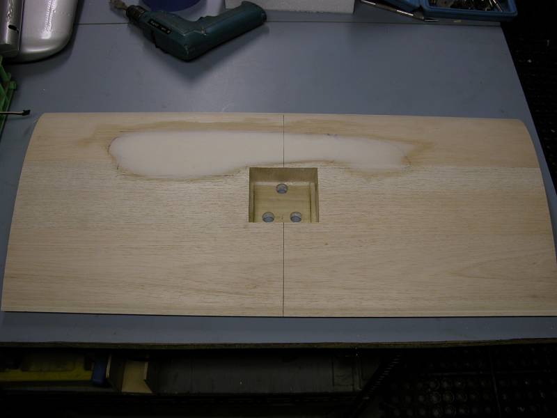

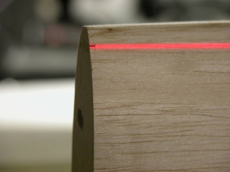

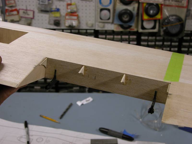

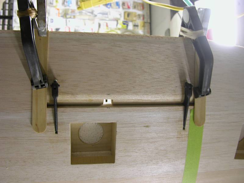

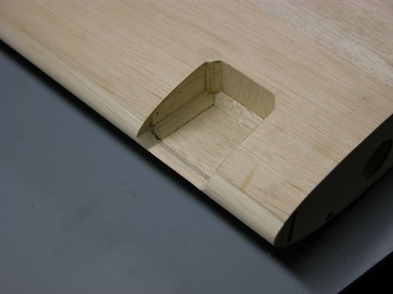

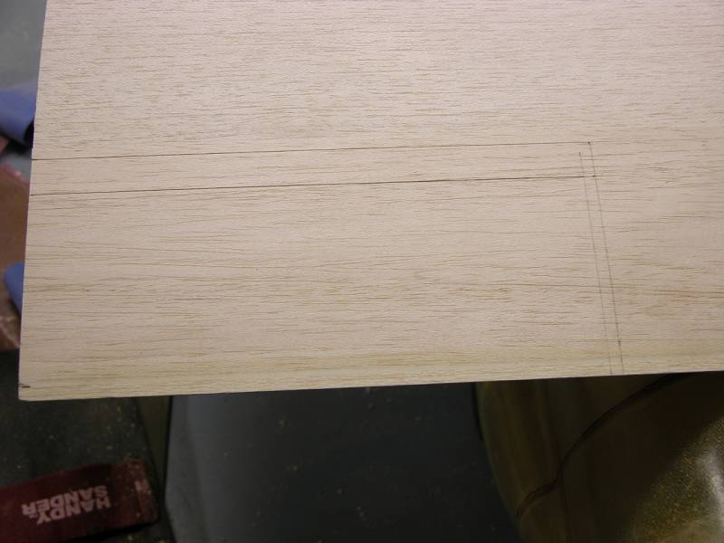

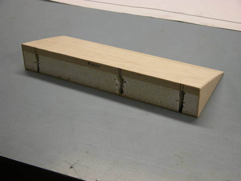

Back to the main center section.
Pic. 1. Balsa joiner cap rib 1/16" balsa. The rear 1/2" dia. hole is for the servo wires. The 1/4" dia. hole is for lighting system wiring (tip nav light and landing lights). The vertical slotted voids are for ply joiner plates.
Pic. 2. Center section top hatch for throt. batt. and it's servo sync. (mach box or equiv.) The white filler is a mess up. I forgot to temporary put in the wing tube while I was vacume bagging the wing.
Pic. 3. Flap bays and fuel tank bays. The 3 holes are for the wires that goes into the fues.
Pic. 4. Also if vacuume bagging, you must add a 1/8" thick balsa sub L.E. to prevent crushing. Once sheeted, just add a 1/4" thk. L.E. stock and sand to shape.
Pic. 5 & 6 Once the L.E. is sanded to shape, then cut out for fuel tank bay.
Later,
Gunny
P.S. There is more on the pevious page

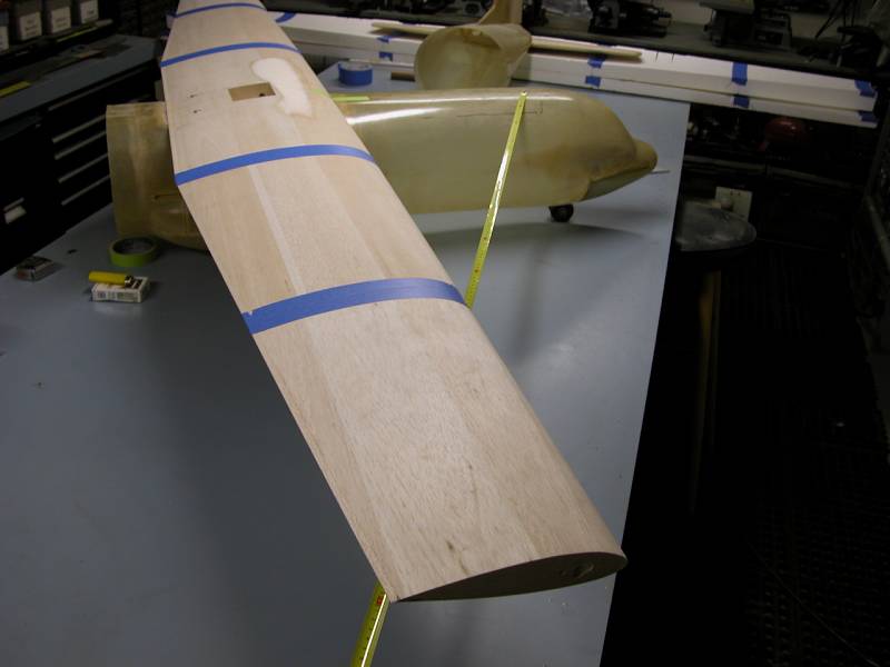

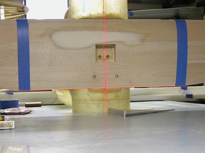

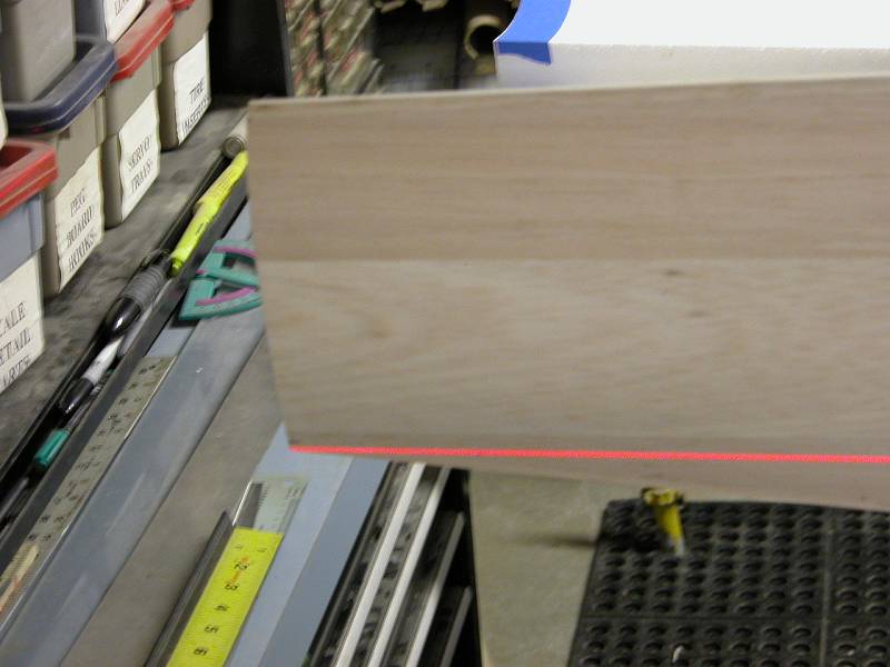

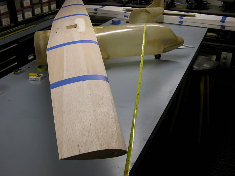

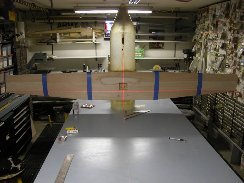

Using an x-y laser on a tri-pod to set the wing assy. perpendicular to the fuse. centerline. Note the wing pannels sections are tightly taped together with the internal main spar/wing tube.

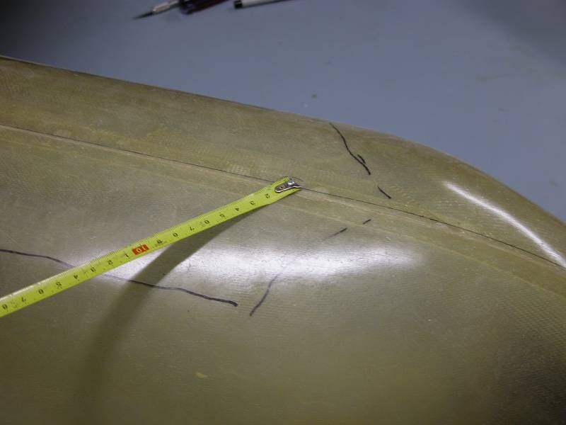

Also double checking A=A dimensions with conventional tape measure. Note, I used an old tape measure that I screwed to the center fues point.

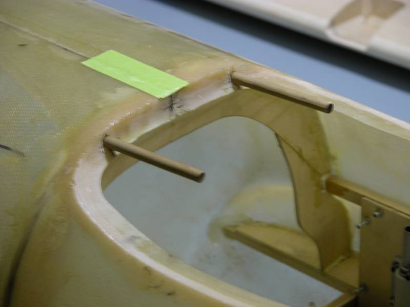

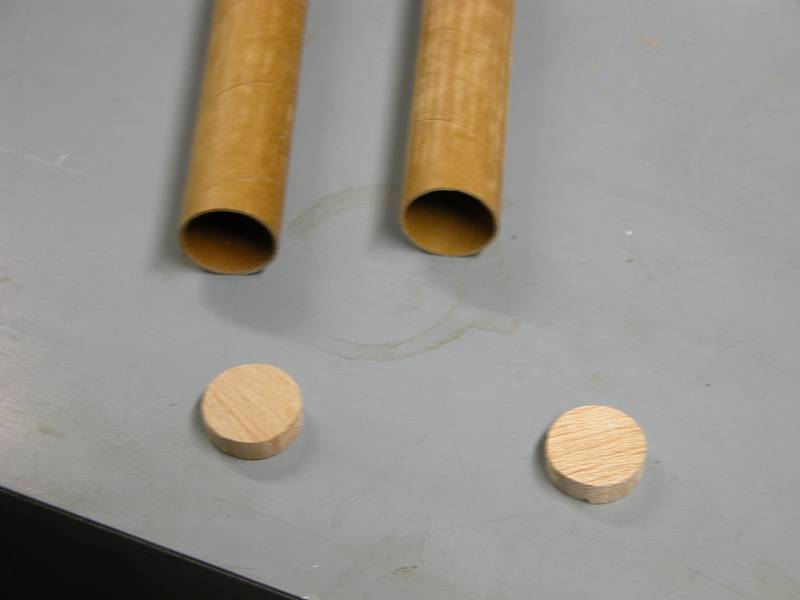

Main wing dowel details.

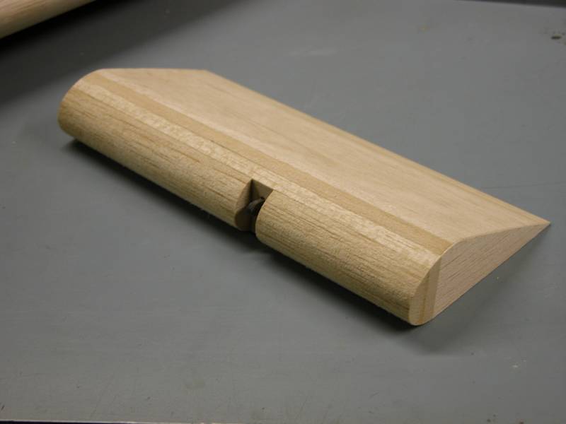

Inboard flap details. The flaps are cut out in the bottom chuck or saddles on a band saw when possible. The control arm I cut out of carbon fiber and the hinges I found at the Toledo show from Yellow aircraft. I used their X-large (simulated) fowler flap hinges and cut the pattern as shown.
