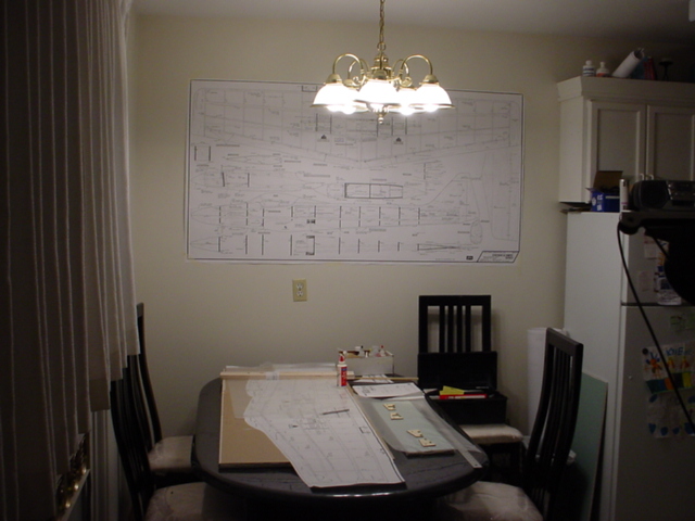

Starting my Duellist.
Wow. The wood blocks in this kit are nothing I've seen before. 1st laser cut kit for me and so far I like it. Its the Pica version and the wood quality seems excellent. Its also the most advanced kit as far a being a 'builders' kit. I guess I've become spoiled by Great Planes and Goldberg etc. Its basically a box of wood, a plan and a manual that says "build plane, cover and fly". Twinman and Will, forgive in advance what might be silly questions.
1) Dihedral. Very little I'm thinking. The dihedral brace they give you can be installed a couple ways with different results.
2) Flaps. I'm thinking from the 2nd rib to the 4th which would make them about 6" long finishing where the nacelle will start. What do ya think?
Here is a picture of my shop and the first bit of work.
Every year about this time I say goodbye to my table till spring.

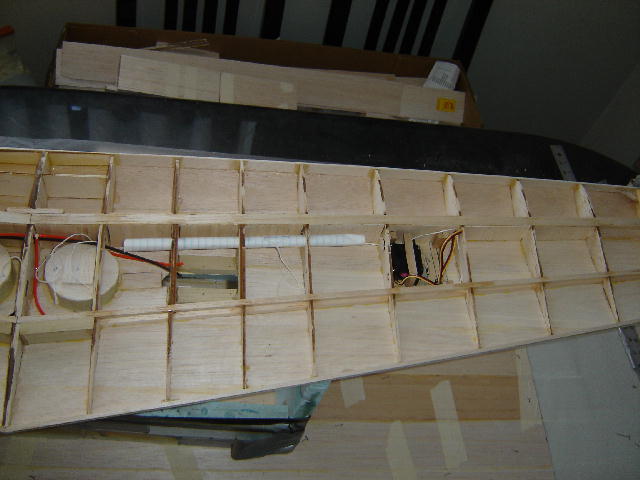

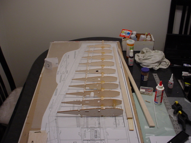

Well the wing frame is done. Turned out real good. Nice and straight and after a bit of careful sanding the leading and trailing edges are good.
Gonna stop here on the wing until the gear comes in so its not sheeted until after the gear is test fit and wheel wells are in. Anyone know if you can still get the pre-fab ones? Don't see em up here.

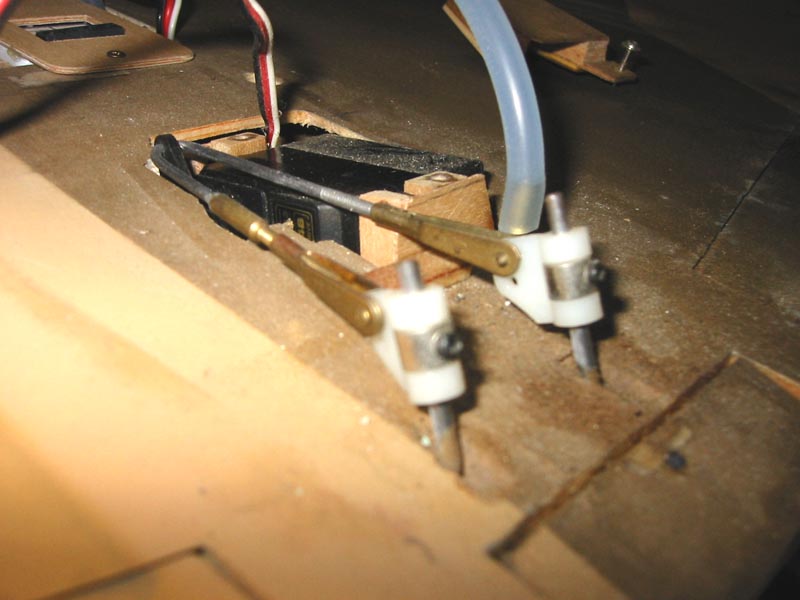

About the servo's I guess using 3 in each wing (aileron, flap and throttle) is the way to go. The flap one would have to be outboard of the nacelle I suppose? Anyone use only one servo for flaps in the centre of the wing and use plastic pushrods (nyrod) out to each flap?

Check the plan. The original used a single servo in the middle for both ailerons, you can still use onr there to operate both flaps. This would not allow flaperons, though. Two servos side by side, still in the center, would work the flaps and still let you have the flaperons.
The aileron servos are the ones that will be outboard of the nacelles.

I am using a single standard servo to operate my flaps. My flaps run from the fuselage to the nacelle. They DO slow the plane down and they DO cause the model to pitch up when deployed (therfore I have set up my Tx to mix in some down elevator to compensate). If I were to do it again, I would do as William suggested and extend them 1 rib bay beyond the nacelle (I'd probably connect the outboard section to the inboard section with a short but beefy torque rod. I would also increase the flap chord by about 1/4" to 3/8".

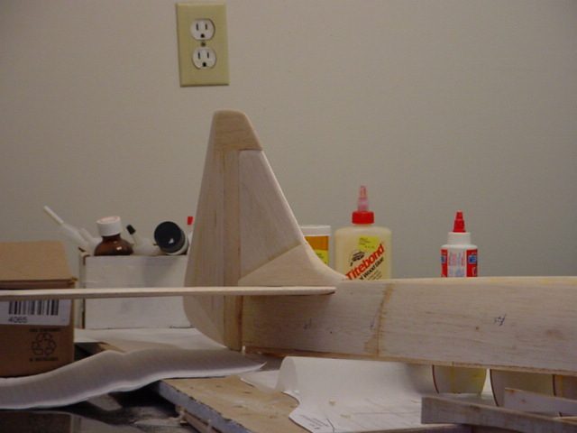

I'm still building but have pretty much as far as I can without the landing gear and its back ordered. Anyone know if there is a problem getting the B&D gear?
Anyway, tail feathers are built. Rudder is about 1 inch longer and taller than stock. Still very impressed with the quality of the wood, but the trailing edge bevelled stock was too short. Someone mentioned a lot of sanding and no $%##@&^% Nacelles are framed but cant finish until their on the wing and dont wanna sheet the wing until the gear is in.
Hey muucksmear, Re your last, the photo seems to show the trailing edge 'notched' to fit the fuse. Thats different from mine. Anyway, the wing bolts are right where the servo will have to go, but I would like to use one servo for flaps instead of separate ones on each wing. The servo for ailerons and throttle out in the wing is enough weight out there already. Any ideas?

Kirknik, not sure what you mean by "'notched' to fit the fuse.". The photo shows the top surface of the wing center section, with centerline of the wing running from the upper left to the lower right of the photo. The short flap-like feature in the lower right is an access hatch for the switch which was mounted on the rear bulkhead above the wing saddle. You can see the root/LE portion of both left/right flaps at the bottom and right edges of the photo. My wing mounting bolts/holes are in the stock location. One of the holes is just visible behind the flap servo wire.
My standard sized flap servo is mounted on its side to acomodate the reduced thickness of the wing aft of the mounting holes. Unless you have other stuff located between the TE and the mounting holes, you could try to do the same.

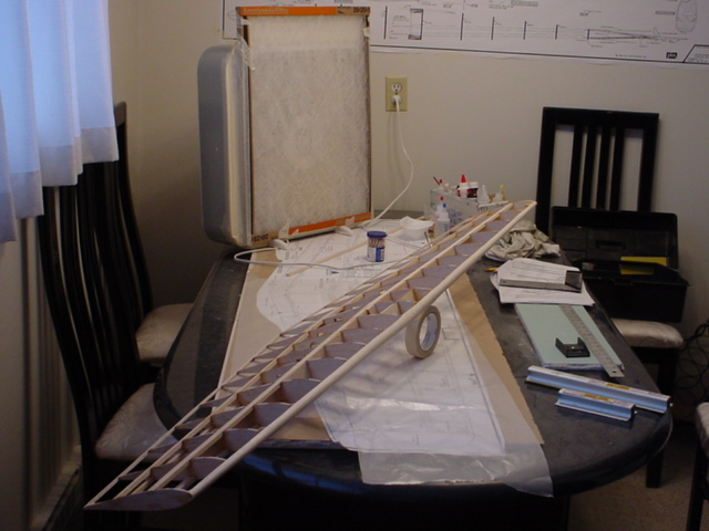

After a bit of delays I'm getting back to building. Wings are sheeted and gear and aileron servos are installed. Put em in sideways so just the arms will stick out. I extended the main gear about 2 inches for more clearance. Havent started on fitting the nose gear. Still very impressed with the kit and quality of the wood. "They just don't build em like this anymore". Thanks to Ledet and his post on scratchbuilding a Duellist. Big help and also an inspiration.
As you know, this kit takes a lot of sanding and then more sanding so notice my automatic sander that I've been working on for 9 years. Works pretty good too.

You did go with the B&D retract set?
Like your sanding robot too. How hard is it to program?
