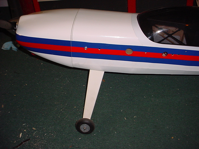

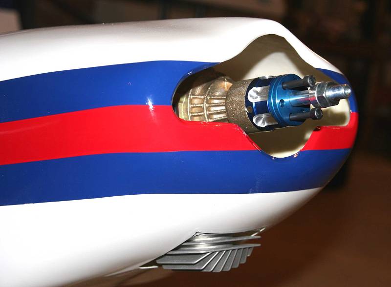

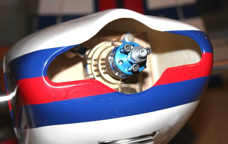

Use the cooling holes in the bottom of the fuse just behind the gear. That way you don't need to cut the cowl and you will get plenty of airflow. The air will flow through the canister box and out the bottom.

Tom, appreciate the tip, was thinking about doing that to preserve the rest of the cowling. Had a choice to cut a hole in the side for the plug if I mounted horizontally. The MVVS 45 would fit horizontally with only the plug and cap needing clearance. Decided to go with the inverted mounting not sure really other than for cooling.
