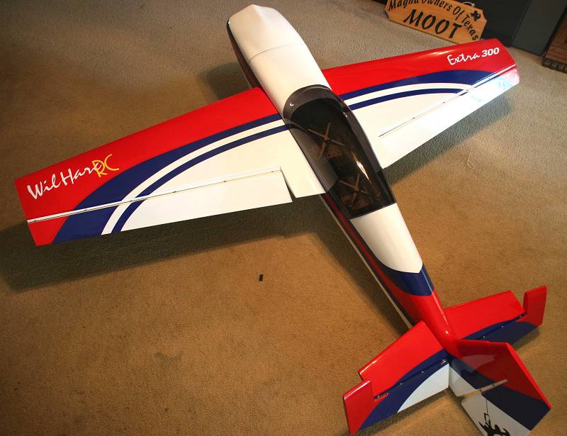

I picked up the new Wild Hare Extra 300 from Tom and Patty today, wow once again great people to deal with!

Very nicely designed and built bird!!!! As one would expect from Wild Hare's offerings.
Planned equipment, MVVS 45 MG (weighs 3 lbs 7 oz's with ignition), Hitec Digital 5945's & 5625's, Lithium Ion packs, Smart Fly power expander, etc.
Just a note, Tom supplied the correctly spelled "wild" for the wing.

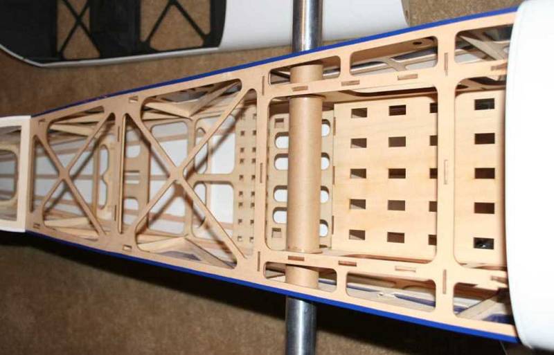

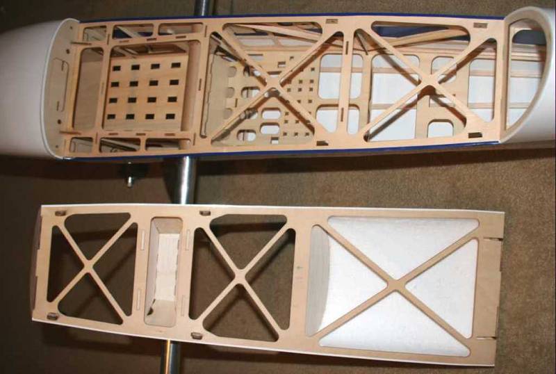

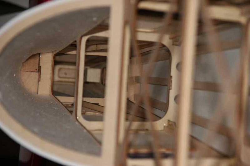

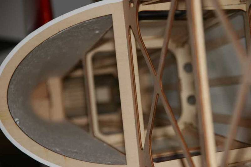

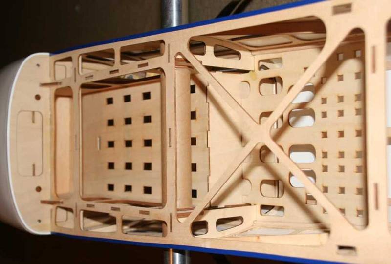

PICs of the interior of the fuse.

Old 07-08-2006 | 09:18 AM
My Feedback: (13)
Posts: 4,749
From: Zachary, LA
Default RE: Newly redesigned WH Extra build thread
Is that a CARDBOARD wing tube receptacle???????
Old 07-08-2006 | 09:22 AM
Greg Cothern's Avatar
My Feedback: (8)
Posts: 611
From: Combine, TX
It appears to be, it is quite sturdy for sure.
Old 07-08-2006 | 12:03 PM
My Feedback: (13)
Posts: 4,749
From: Zachary, LA
ORIGINAL: Greg Cothern
No doubt. But here in the sub-tropics, I wonder if the high humidity will make it swell/contract with temperature changes.
I seem to recall that the first batch of GP Patty's had a cardboard tube, and it caused all sorts of headaches; mainly wing tubes that didn't slide into their receptacle.
Not bashing; just voicing a legitimate concern.

Old 07-08-2006 | 01:56 PM
rctom's Avatar
Joined: May 2002
Posts: 6,189
From: Flower Mound (near Dallas), TX
We have been using paper tubes since we started. There has never been a complaint about them changing sizes.
I did try phenolic tubes on one set of prototypes, they were OK but the paper tubes have one big advantage. If the fit is a little too tight the tubes can be sanded to fit. You can't do that on a phenolic tube.
If you buy a plane, then go and buy a CF wing tube or other aftermarket product that is not exactly the same size, you are pretty well out of luck. But with the paper tubes you can sand the tube to fit.
TF

Old 07-08-2006 | 05:57 PM
airborneSGT's Avatar
My Feedback: (15)
Joined: Jun 2004
Posts: 1,619
From: APO, AE, GERMANY
That cross bracing is very impressive. Just looking at the design I can tell this will be able to handle the most violent 3D flying. The hatch area tends to be a weak area in any aerobatic rc plane. Seems that someone has been doing their homework.

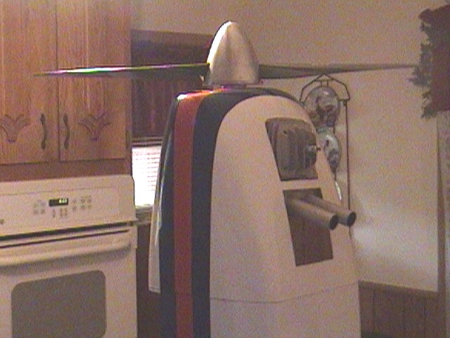

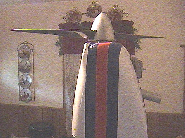

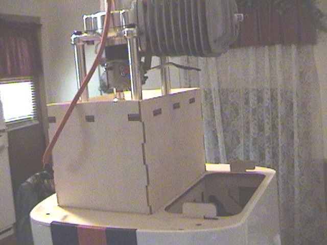

Silversurfer I agree. I had the special and with it I had unlimited vertical with my DA50. It came out at 18.7lbs. Yea, she was a little chubby. But I was real excited to hear this one was coming out lighter then the special. I was concerned that by making it lighter it would compromise the integrity of the structure. But I'm really impressed with the way they took out the excess weight and still maintained the strength. If it flys anything likt my special and is a pound lighter,I will be a happy camper.
I got the motor mounted on mine last night but it looks like I'll need to get a larger spinner.
There is also red and yellow scheme.

Old 07-09-2006 | 10:43 AM
rctom's Avatar
Joined: May 2002
Posts: 6,189
ORIGINAL: airborneSGT
Red white and blue all thats available on this shipment?
Yes, that's it for now, they are almost all gone anyway.
There was a language problem when I ordered, they translated "it's ok to send white/red/blue also" to "i want only white/red/blue".
No big deal, the red/yellow/black will be here in a few weeks.
TF

Old 07-10-2006 | 08:53 AM
Dangerous Dan's Avatar
Posts: 1,820
From: gainesville, TX
ORIGINAL: Redneck Shaun
Shaun,
Looking Good! Make sure you open the cowel enough to allow your spark plug wire back in without rubbing. Fiberglass cuts sparkplug wires like a knife. I have some screen spline(line the cowel opening) and automotive vacuume tube(protect the plug wire) you can borrow. In order to use the screen spline you will have to get rid of the corners in your opening. Here is a pic of my 260 cowell.
Dan
