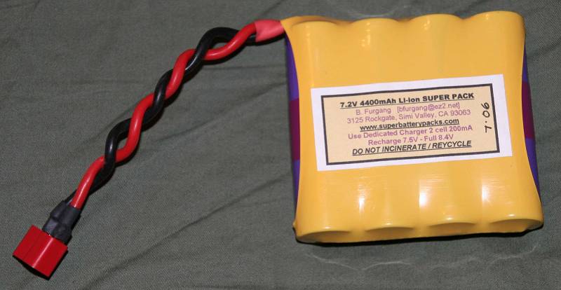

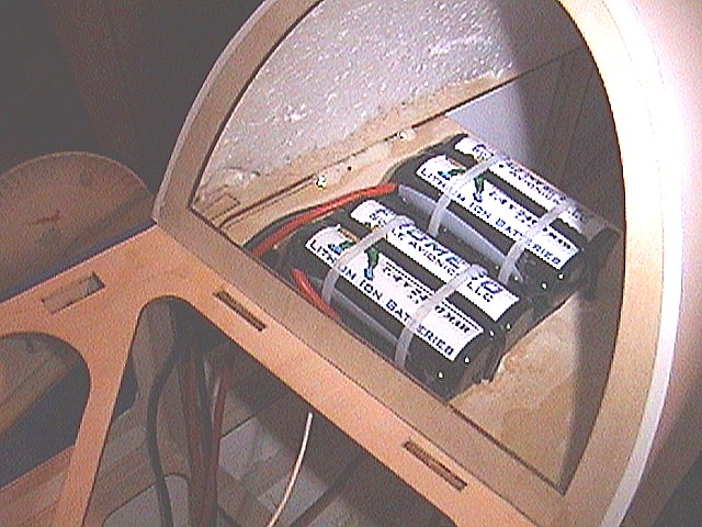

I decided to go with a 4 cell 7.4V 4400MaH Lithium Ion pack with 16AWG lead and Deans connector from Super Battery Packs.

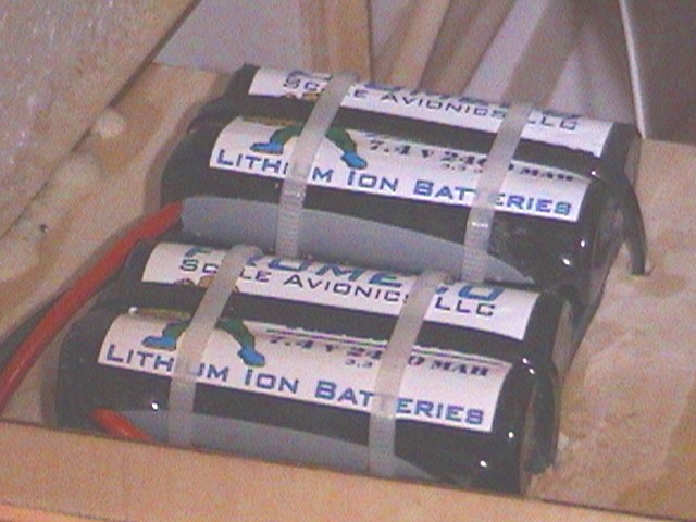

Man ....That's a hoss!!!! I ended up using three Fromeco 7.4v 2400MAH. The only thing is it looks like my CG is going to be a tad forward then I thought it would be. I ended building a tray with the extra spare wood.I mounted it aft the pull-pull rudder servo to hold two of the batteries. The other battery I will mount just forward of the rudder servo.
In all honesty, I probably could install the rudder servo in the tail and get a lot closer to the wanted cg range.
Here's a couple picture of the tray I built tonight.

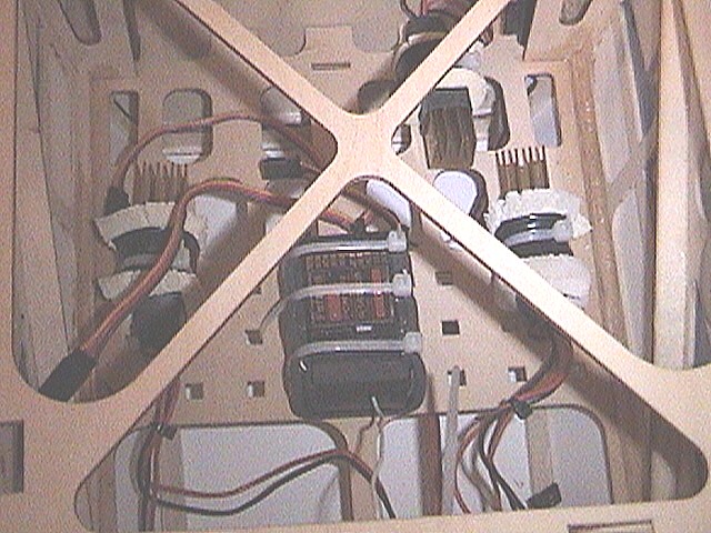

Here's the radio position, and the tail area. I'm almost ashamed to show the pictures before I have a chance to clean up the wiring.

Bern from www.superbatterypacks.com and I believe all and all they cost me $65 to my door.

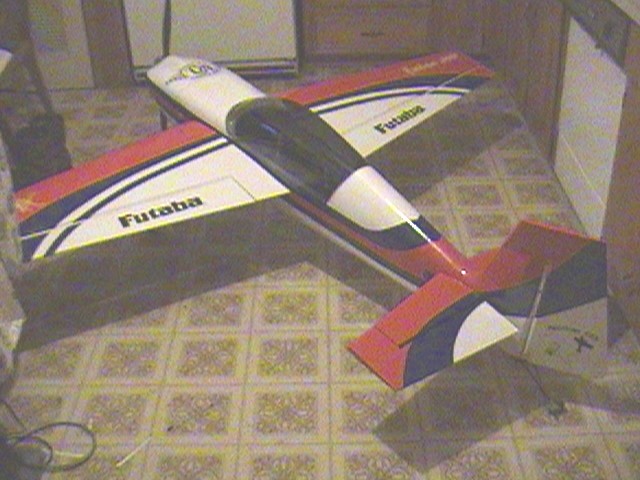

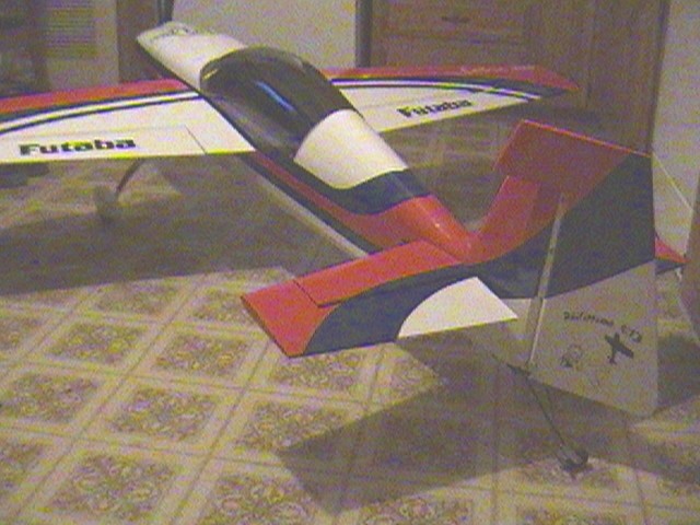

Getting close..... This is by far the best looking plane I have had.

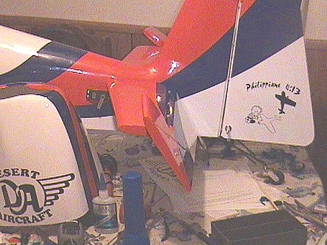

Couple more......

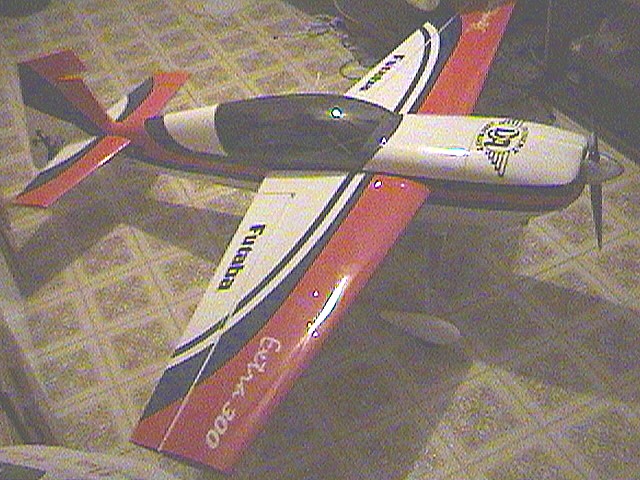

It looks a lot larger then the extra special. I guess it's from the wider fuselage?

Almost ready Scott, I need to finish the Pull-Pull rudder, re-route some of the wiring to clean it up a little, and seal all the surfaces. Then give it a good once over.
She should be ready some time this week.
