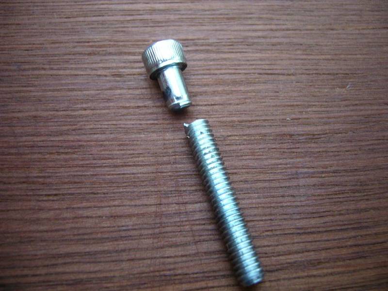

Troy, is the third 110 and I have the first version "S", but to give the maximum RPMs the engine vibrates a lot.
You put a picture of how I am one of the screws by vibrations ...
What is the problem ... the screw? the bank?
Thank you.

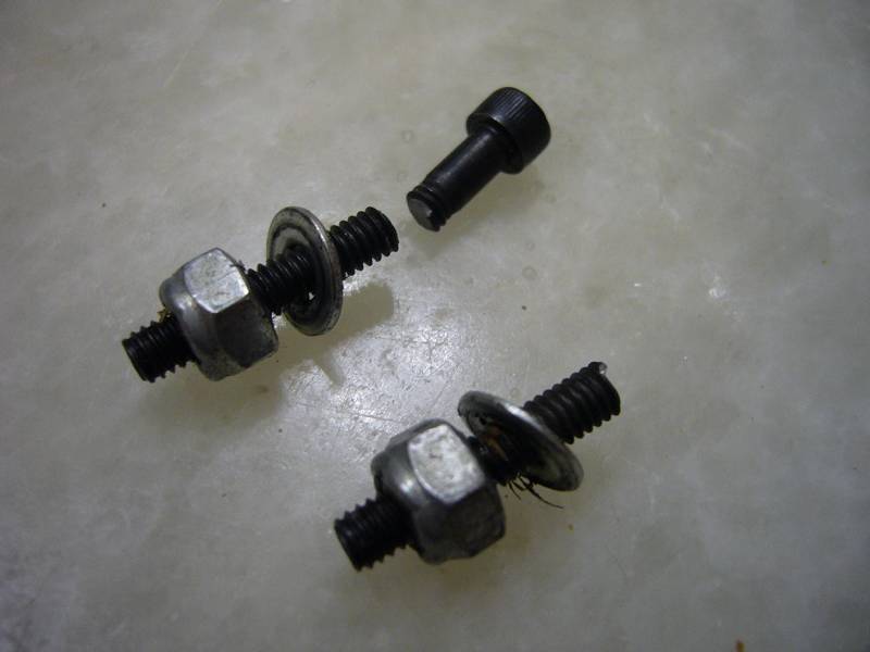

And still the screws broken by the vibration ... I do not understand because I have bad luck with my 110.

Wow,
There must be something wrong. Prop out of balance? Center hole in the prop not centered in the prop hub. I have never seen one break bolts like this. Those are larger bolts...I use 4-40 bolts or 3mm Bolts to hold my engines in place.
The other possible solution is a bent crankshaft. However I doubt that is the case on a new engine.
Perhaps you should it to YS Parts and Service along with the prop you are using...
Or check the balance on the prop that you are using.

Always use screws 8-32, with this FZ110S and my previous FZ110:
http://www.rcuniverse.com/forum/m_6359824/tm.htm
The propeller is balanced. I will test the engine in another place.
