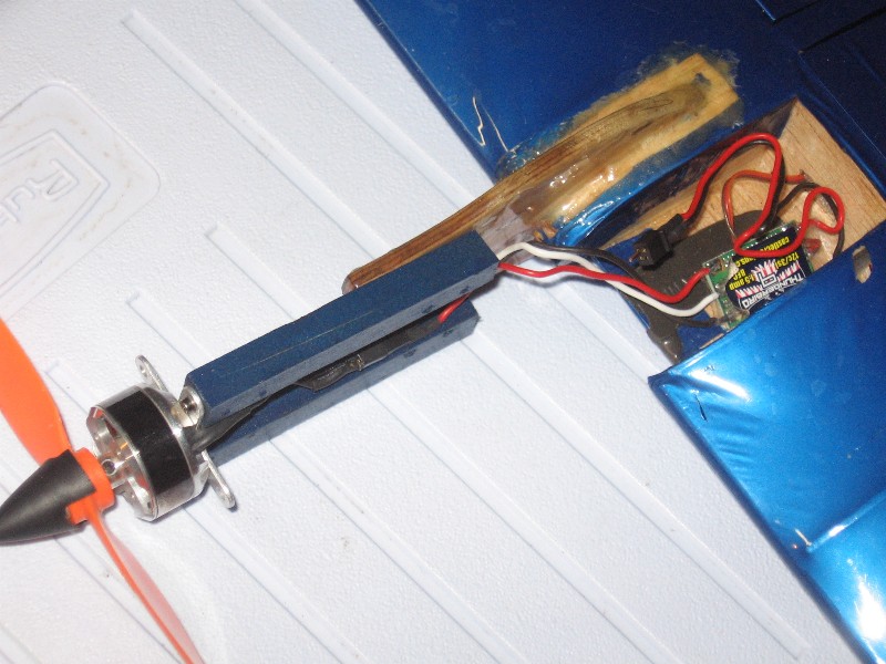

I hang my head in shame and admit that I have converted what was a 1/2a screaming, streamer cutting, beast of a combat wing know as the "bulldog" into a E-powered park flyer. I did this primarily to have a plane to take on the road and not have to deal with all the glow stuff. I flew it at the cost on a bluff and also let a friend fly it for his first ever RC airplane experience. He did very well despite the wind. It actually weighs an ounce less now, so thats 11.75oz with 360 square inches. It's a real floater and easy to fly. I used a GWS brushless motor on 7.4v with 8x4 prop. It maintains level flight at 1/2 throttle and will climb in a thermal. I'm pretty surprised at how well this wing flies at both ends of the spectrum.

It's definitely been neutered... It's probably lacking a 1/3 the power from where it was with the Norvel. Maybe even worst then that, but if you want a relaxing/training wing it's not a bad setup. I'm sure you could do combat with it. It would probably be similar to the larger SSC wings you have as far as speed and action go, but flight times would not be very long unless I got a bigger battery. Here is a pict of the motor install. I consider this a down and dirty temp setup (cause I still want to do more 1/2a combat[>:]) so I just electrical tape a 900mah battery behind motor to the sticks. I think it would take all of about 10min to convert it back and forth....

The motor raineday posted a link to is the one, so those specs should be close.
Bruce do you know how may watts a nice running Big Mig 061 on a 6x3 puts out?
If you want to rate in on the climb-o-meter it climbs well but does not have the vertical it did with the Norvel.

My set up could be done for $53
GWS Brushless $14
900 mah 7.4 lipo $13
Castle Creation Thunderbird 9 ESC $26
