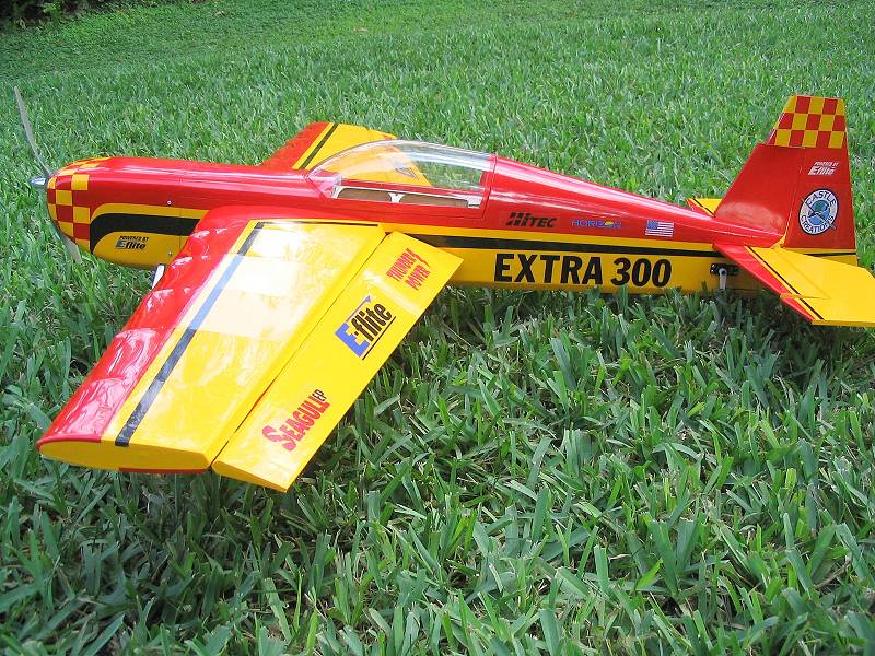

The covering does "sink" in between the ribs, however this is not a mistake. The wings leading edge is not sheeted and that is why it does this. Not to worry though, it doesn't affect the flight.
I am using the Park 480, Eflite 40 amp ESC, with APC 11x7 E prop, TP2100 Pro-Lite. Berg Rx. I am going to maiden mine today, or perhaps tommorrow. I really like this plane and have it setup like the manual said. The only thing I am going to change is the landing gear. The gear is sturdy enough, but I don't care for the design of it. JMO.

Guys I couldnt resist. So I just bought one of these.
OH MY....
WOW what a plane. Ive never been impressed with the seagull models, but this thing is FANTASTIC. I think this is truly gonna be a winner. What a surprise.
Honestly this is on par with higher end micros like the Hyperion birds. The landing gears is a great design, but leaves me wanting more in the "asthetics" department.
Very clean, simple design. Very good classic extra looks. The covering is pretty good, tight, and clean. The turtledeck and aft cockpit deck is flawless....very well done.
I would recommend hitting everything you can reach with CA..it doesnt look like they even glued it.
The leading edge of the wing is just a stick of balsa, resulting in the odd stretched appearance of the leading edge. Its not really an issue unless your really picky, and really...you should be happy. It makes it MUCH lighter.
Im also extremely pleased to see a one piece elevator. No gluing reinforcements, elevator halves together, etc. Just hit the hinges with CA, and yer done.
Based on my initial views, I think they did some serious research with this plane, it seems to be VERY well thought out.
The cockpit design is probably the best Ive seen on any small electric kit. Super Secure latching system, Fliton and E-flite...take notice, Seagull did it right!... it even has the nice added touch of realism by them placing a full color instrument panel inside the canopy. Sweet.
Oh, and they also included a removable battery tray. Rubberband the battery to the tray, and then you can just take the tray in and out with one screw, vs velcro straps everywhere.
Wing area is generous, and surfaces are large, which should equal good 3D performance. I have a feeling that roll rates are going to be insane. LOTS of expo on this one.
The plane goes together in a very short amount of time. A single evening is all you need. Even the most newb pilot could build this in a evening. Piece o cake.

I maidened mine for about 5 minutes this morning and it flys great! KE's good, hovers no problem, didn't really have much more time to really put it thru it's paces but it was sweeet! Some of you may not realize that this plane has what I would call torsion bar landing gear. The gear under the fusalage actaully twists and allows the LG to move rearward if an impact occurs. Truely revoltionary!!! This one's a "keeper"!
My setup:
E-flite 480/910 Kv
APC 11x7E
TP 2100 Gen 2 (yellow stripe)
HS 55's
HS 65 on rudder
Phoenix 25

Well, I went with the manual recommended throws, and it cost me. DO NOT FOLLOW THE MANUALS RECOMMENDED THROWS. If you do, it will crash.
3/16 on ailerons as they recommended will result in ZERO response on ailerons, and the 3/8" high rates are a joke. They too are insufficient.
You need 1/2" low rates, and 1" high rates on ailerons, about the same on elevator (but with expo), and rudder...well I fly with full deflection in all modes (I like rudder, and tons of it)
I CA'd it back together enough to get a flight out of it. It was flying great, about mid-flight, the horizontal stab snapped in two (it was damaged from previous crash) I literally had a V-tail, and the right horizontal stab and elevator was flapping like wings on a bird. All my friends thought it was a done deal. OH no...I was determined not to lose this bird. With the horizontal stab folded I actually brought it around, and set it down in a perfect three point landing smooth as glass. All my flying buddies were looking at me with their mouths hanging open. One of the guys said he wished he had that on video, because no one would have believed it. It was a miracle.
I didnt tell them, but honestly, It was still controllable surprisingly. I had a reasonable amount of elevator control even with all the flapping. I think they were more puckered than I was.
I took the broken hulk back home, and cut the broken horizontal stab out, cut the covering off the wings, rebuilt both wing tips,straightened the wing tube, built a new horizontal stab, and recovered it to match the original color scheme. You cant tell it was ever busted up except for a scuff on the cowl, and the Red is a little off shade.
Now...on to the flying ability....
WOW WHAT AN AIRPLANE!!! This thing flys 100 times better than ANY of the other planes in this size range like the Mini Funtana, Mini Edge, or even the Brio.
Dont worry about it not slowing down. Even at 26oz, it floats like a feather. I was absolutly shocked at how it floats. Coming in for a landing is fantastic. No odd stall charectoristics, no wing rock in harriers. ROCK SOLID. It hovers great. Almost like hovering a foamy. Spins are good, but do require slight opposite controls for exit. KE has a little pull to canopy, but nothing that cant be mixed out. Inverted flight is smooth, and neutral. If you program spoilerons into it, it will do GEORGEOUS perfectly vertical harrier/elevators.
I love the plane. It flys as good as it looks. I HIGHLY recommend this thing to any of you guys that are tired of the poor flying planes this size. Its fantastic.

Here are some post-mortem pics after it is all repaired.....and yes the horizontal stab is now SOLID, instead of built up. The elevator is however still built up.
