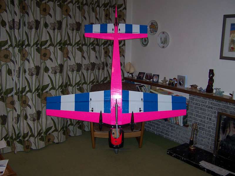

Aye the cowl. Got some pink paint out of Halfords and it was an exact match for the pink solarfilm so went ahead and painted it. Unfortunately when it dried it went much more red so it doesn't match very well. Actually looks not too bad though. Rest is gold and metallic blue. I left some of the carbon showing and then lacquered it.
Bottom looks like this...

nice,whats the power unit?whats that flexi pipe made from angus,will that withstand the heat.looks a good scheme though,[8D]

i like the bottom, should be good for knowing which way up it is......
but the cowls got bronw on it from the first pic u posted?

like it Angus it would be a bit femanine for me but the scheme is good and i like the bottom as Mikey says whats the powerunit and what pipe and manifold is it.

Feminine!! This is a mans machine boys!
Its got a 140DZ, AAP power manifold with a PTFE joiner. Thats an old two stroke pipe from Phil Williams but it didnt like it so put I put it on my trusty Hatori 693.
First flew it on an L but it was pants. Goes pretty good on the DZ but you'd be struggling to do any kind of F3A manouvers in a wind.
Angus
ps Its def gold on the cowl i assure you [sm=sunsmiley.gif]

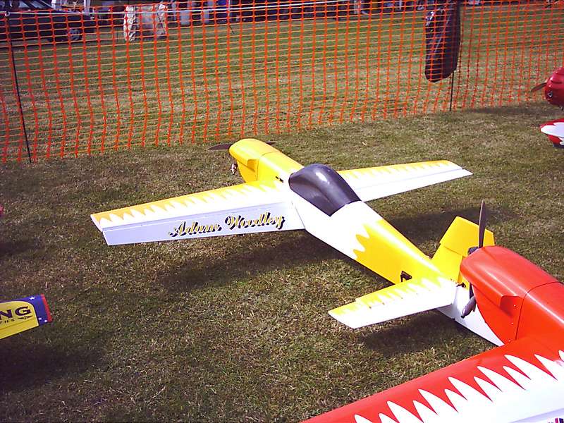

we are men thank u very much heres the pic of my plane (red)and my brother's(yellow)our planes.
Before you say it Angus YELLOW isnt femanine!!

ORIGINAL: Angus B
Angus
Strugguling to do F3a stuff, hows that, thought the DZ was very powerful.
How heavy is your machine.

Suprised by your comments angus about the C140 being pants with the 140L - mine goes very well now ive got the right prop on it - it enough for pattern, but would want more for blasting out of the hover a little bit more. Ive got an APC 17x8N on my 140L.
Kane ive got a Multiplex Mini DS IPD 9ch reciever in my 140 and 50.
Oh what if any differential are people using on ailerons? I dont have any in, but was wondering if anyone has had any improvments experimenting with this?

Lookin good Kane. You guys should do synchro.
My plane is about 10.5 lbs. Started it off on an L on 17X8 but it just didnt seem to have enough punch out of the prop hang. Now got DZ on 17X10 and its much better. Got 18X8 im going to try this weekend if the weathers ok.
Think its mainly to do with all the drag of the big nose and the massive main gear as my Synergy is only about 5oz lighter and on a DZ its near ballistic. Its an excellent plane for the 3D stuff but ive done a bit of F3A with it and as you're flying much faster the drag then becomes an issue. Didnt buy it to do F3A anyway so it does'nt really matter, was just an observation.
Angus
ps got +15% differential (15% less down than up i suppose) on my 10X and its rolls much more axially. Hope this helps
