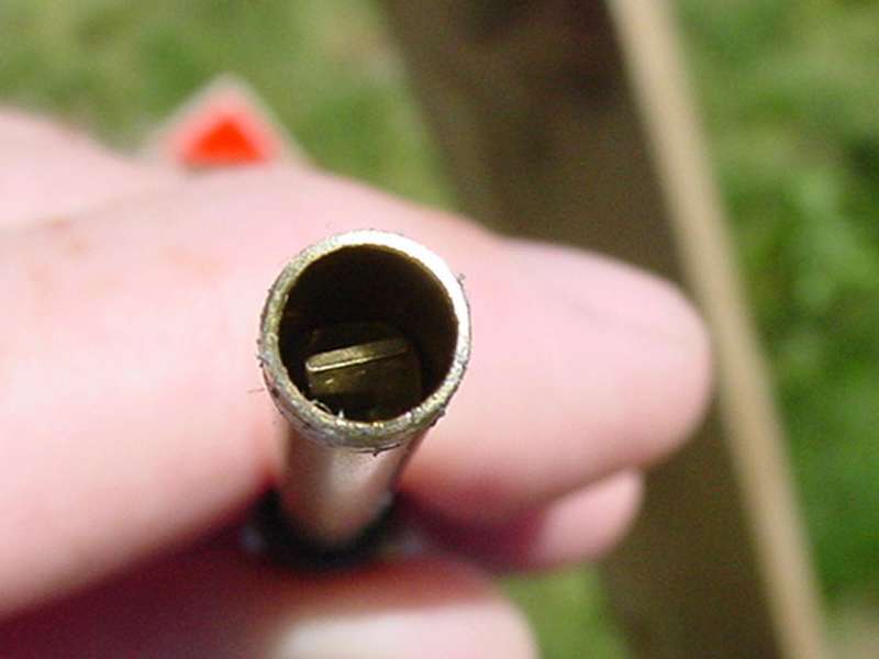

I did remove the smoke insert and made a blank to replace it. I might fit smoke after the break-in is over...if I can wait that long? Any recommendations for the DA-50?
Eric.
