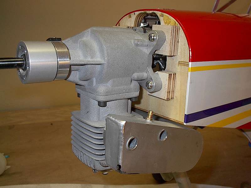

Here are some pics of my ZDZ 50 install in case anyone was contemplating using this engine. Pretty straightforward, cut hole in firewall, line up engine using cowl, then I used 1/2 standoffs. The Bisson muffler
took a big chunk out of the cowl though
Some of my Purple covering also came off while I was working on the various pieces, so I went back and ironed down all the rest to try and keep them from coming off also.

I have a Double vision, and just happend to have my brison 3.2 out of my Midwest Cap 232 while I work on the 232, so just for jollies I looked to see how the Brison would fit in the Double vision. I can tell you that it would require opening up the entire side of the cowl from the rear to the point where the carburetor mounts on the Brison. It really would not fit very well. The narrowness of the cowl almost excludes any gas engine other than ones with a rear mount carburetor. It could be done but would not be pretty.
I have been holding off buying an engine for the Double Vision until I heard how well the DA-50 would haul it around. So far it sounds like the DA-50 has plenty of power. I had considered a zdz 60 but it weighs almost 4lbs, at that point a ZDZ 80 only weighs a little more than the 60. I would prefer to stick to the light weight DA-50. According to at least one post in this thread it has plenty of power. Has anyone else flown the Double Vision on the DA-50?

I have a DV and I agree with scooter j. You'll need a rear carb engine if you don't want to cut the cowl up too much. That leaves you with very few choices for engine. ZDZ 50, DA 50, and the 3W 50I. There are probably a few other obscure rear carb engines out there, but I can't see using them when these I've listed are so well known.
