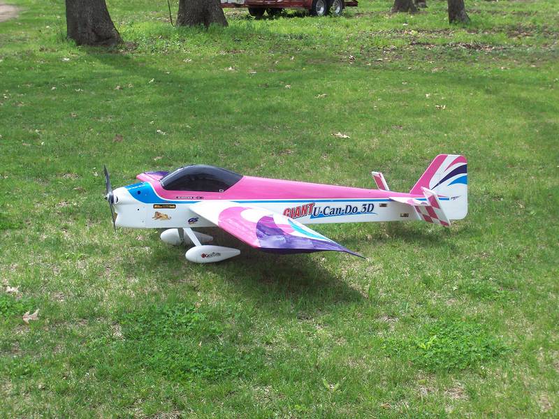

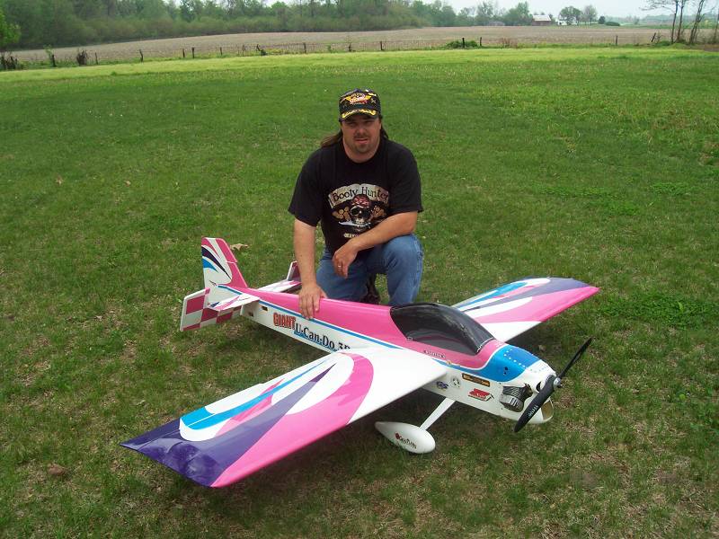

Hello guys was just crusing the universe [NOTHING ELSE GOING ON U KNOW HOW IT IS] came across your threads on the UCD thought I would chime in
I have the giant UCD with a super tiger 3250 on it swinging a DYNATHRUST 20X8 prop WHAT A COMBINATION IT JUST KEEPS GOING UP fly aruond on 1/4 throttle will hover between 1/4 and 1/2 throttle with motor to spare for vertical climb out love this plane heres some pics

Looks sharp, can you run with 0% methanol? That would save a bunch of $$ with that hog up front. I buy it from a race track near by for around $3 something a gallon.
