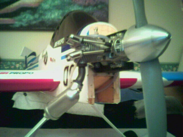

gjeffers's Avatar
Joined: Sep 2004
Posts: 2,307
From: Round Mountain , NV
Default RE: U Can Do 3D
ORIGINAL: davepa
hi everyone. Im setting up my ucd 46 and need some help with the tank installation.The manual is kind of vague.Anyone have any helpful hints on tank setup or maybe some pictures.Do you just wrap it with foam and stick it in the front of fuse.Manual says glue a balsa block to hold in place.Any suggestions appreciated. Thanks Dave
ive always done mine just as the manual says. have had two and there are no issues with it.
i have used two different methods to fuel, one being a fuel dot(which i think is best) and the great planes easy fueler valve, which worked well till it started seeping fuel, which also means it could suck air also.
but what ever you do...re-inforce the LG, i used two screws as in the pic, just make sure you drill the holes offset to the two LG mount screws

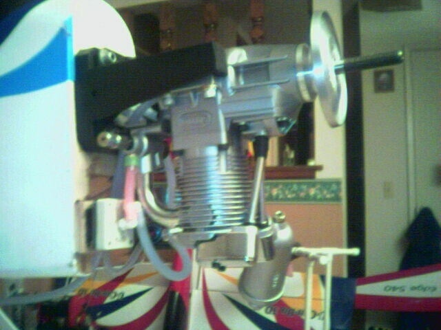

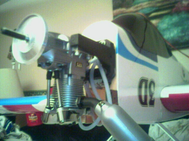

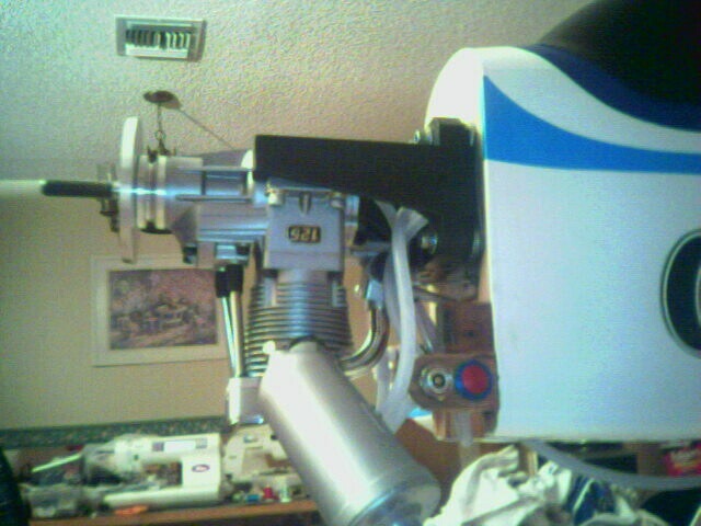

gjeffers's Avatar
Joined: Sep 2004
Posts: 2,307
the 100 is ok (my first) but the 125 is the ultimate engine for this plane, ive had three of them. the 125 is only 4 oz more weight but loads more power.
the last picture is the final setup with a sidemount, works best

gjeffers,
can you get the cowl on w/ that 125 side mounted?
Mac
Old 10-21-2007 | 07:16 PM
  #3345
gjeffers's Avatar
Joined: Sep 2004
Posts: 2,307
ORIGINAL: The MacDaddy
gjeffers,
Mac
yes sir Mac! just a little precise dremmeling needed

hi Rob, yea the 125 side mount works great, you can see the throttle setup on one of the pics and it works real good even if it looks iffy, its not, it has great response. congrats on the 60, and with a 125 you will love it.
