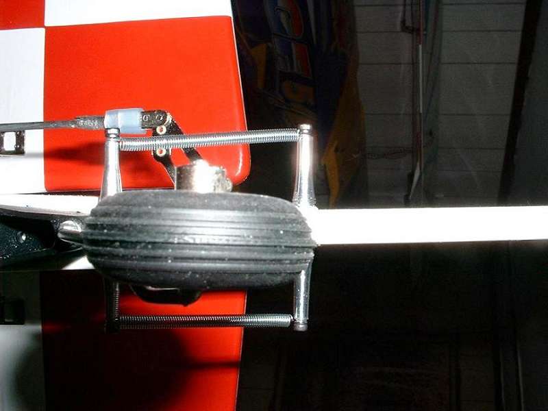

Here is what I'm doing for setup. Staying with the original servo mounting in the tail, placing the tank on the CG as others have in this thread, moving the engine as far back on the mount as possible allowing the cowl to fit in order to help the aft CG.
Tail wheel assembly, I used the tail wheel that was originally on my AW 90 Edge, it bolts to the bottom of the fuse and mounts to the bottom of the rudder by way of rod sticking up through the bottom of rudder. I sliced off 1/6†from the rear of the fuse and epoxy a piece of ply for mounting.
The plane was purchased for the engine and pump I already had in my inventory.
OS 91 FX / Perry Pump
HS-5245MG's on each elevator
Might me light on the rudder but a HS-545BB sets in that spot. Have a HS-645MG standing by just in case I need more tail weight.
HS-425BB's setting on each aileron.
HS-225BB sits on the throttle, located just in front of the tank.
720mh NiMh not yet mounted, waiting for CG placement.
7 channel supreme receiver.
Rudder, 4/40 threaded on one end and solider clevis on the other. Elevator 4/40 all thread on each surface and 4/40 all thread on the ailerons.
Surface horns used were the tri-horns carried by world models.
Main landing gear may change depending on what I have in my inventory.

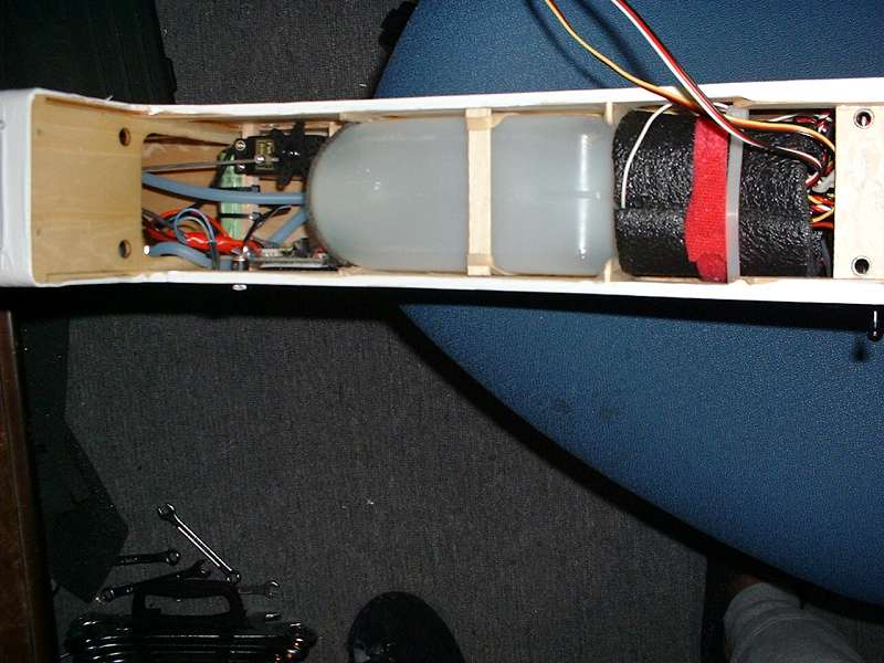

Hi Guys,
I started building my UCD as my Winter plane but now it's Spring and still not done
I still have a Dave Patrick Edge 540T/DA 50 combo to build for Summer. The pics shows all the mods I made for my UCD so far. With these mods in place, my CG is on the button at 6" I have HiTech digital servos all around using 4-40 push rods, all running off of a Futaba 7 channel RX. I am having some glitching with it and will install a Hitec Supreme 8ch instead. I will be using a Saito 91 Golden Knight and an APC 15X4 prop with a Cline regulator for power. I am using a 6V 1300mA NiMh for my battery pack.

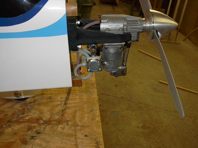

I have a UCD 46 and UCD 60. The 46 has a saito 72 and the 60 has a saito 100. I'm currently running a APC 13x4W on the 72 at 10700 rpm. Is this prop too small for this engine and what is the ideal rpm range. I was planning on putting a 14x4W on the 100. Is this prop also too small?. What prop is recommended for each engine? I'm sorry if this answer is in this forum somewhere, but I did not want to read all 2000 + post. Any information would be greatly appreciated.
Some people don't mind running their 4 strokes over 10K rpm, but I never do. Ideally I'd shoot for a prop that gives you a max rpm around 10K. Then back the RPM down about 200-300rpms. A running RPM of ~9800 is about right in my book.

Last season on the Saito 100 I ran the 15/6 APC. Right now I have a 16/4 just waiting to spin up. Like Coo said, should be a stump puller. I'm still looking for a 15/5 or even a 15/4 to try. I'll have a report on the 16/4 when the weather co-operates. This weekend looks promising. Joe
