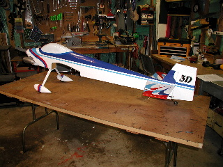

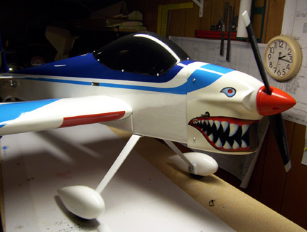

Old 04-25-2003 | 03:19 PM
  #1051
My Feedback: (33)
Posts: 105
From: Benton, KY
Default 3rd and last pic
3rd

I'm running an OS 91 Surpass on my UCD and had siphoning problems right off the bat. So I took it in for surgery and lowered the tank. Haven't had a chance to take it out for a test run. By looking at the bottom you wouldn't know that anything had been done to it, as I used the old tunnel and made it shallower. I dropped the tank 1.5 inches, and it was easy to do.
Loren

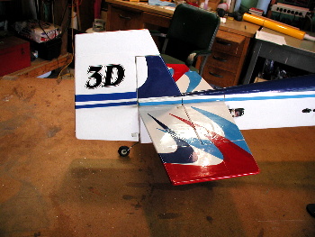

I decided to do what you suggest about the rudder coupling issue. Although I haven't flown it yet I believe it will be a helpful fix. I plan to fly it tomorrow (weather permitting). This time I took pictures of what I did throughout the process and will post them sequentially over the next 6 posts including this one. The whole process was quite easy and took less than an hour to complete. Overall, after cutting off the top of the rudder and then adding a new cap for strength and to get the new desired height the rudder height was reduced by 2.25 inches.
This first picture shows how I simply cut away one side of the monokote down to the first cross member of the rudder. This gives visible access to everything that needs to be cut.

Here is the 2nd picture of 6. This picture shows the cut away portion of the top of the rudder. Note, I never peeled away the monokote from the other side (didn't have to).

Here is the 4th picture of six. This picture shows the new top which was added to the rudder for both strength and to get the new height. It is a solid piece of light balsa which is 5/16" thick. I just eye-balled the shape and glued it with thick CA. My UCD is currently balanced at 6" so I didn't care if I added a little extra weight to the tail but it really didn't change the balance point much that I could tell.

Here is picture 5 of 6. This picture shows the completed tail section. I just used white monokote and plan to re-trim more color after I'm sure it flies OK.

Here is picture 6 of 6. This picture was included to show the entire fuselage and to give an idea of how the overall proportions look after shortening the rudder by 2.25".

Well I flew the UCD for the first time today after having removed the top 2.25" of the rudder (see earlier posts and pictures). It flew as hoped for with very little coupling needed. The plane was as stable as it has always been in normal flight. There is no apparent loss of rudder control (remember, its a huge rudder to begin with) and the plane still does knife edges and knife edge loops with ease but now without the need for a lot of mixing. Transitioning from a left to right or right to left knife edge can now be done without a lot of roll or elevator correction. It's now flyable on hard rudder maneuvers with just manual use of the sticks. However, after several flights I did reset 3% elevator mix (used to be 12%) and no mix for ailerons (used to be 5% mix). Flat rudder only circles are very easy now both upright and inverted. There is less wing rock in harriers and hovering even seems a bit easier. I wish I had done this from the beginning but who knew? I agree with NOSRAM's earlier post stating "for all its good points its a shame that Great Planes couldn't have finished the job, with no rudder cross coupling, and a tank at the correct height."
