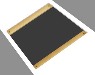

Originally posted by coomarlin
Good call. I didn't even think of that. The weight of the battery will produce more stress on the tips of the hatch. How much more does light ply weigh vs balsa? With a lite ply hatch and the mounting rails I don't want to end up adding a lot of wood that will increase the weight to a point that I could just add lead to the tail and forget about a hatch. What do you think?
Or maybe there is a better way to mount the battery inside the fuse and then there would be no stress on the hatch.

First of all, you should determine how much lead you need to add to the tail. That has a long tail moment and you might not need to add much.
Then, if necessary, move the battery pack back. I would put a hatch on the side if you can. If the battery pack weight is on the hatch, putting it on the bottom will pull the screws out on a hard landing.

Instead of using corner pieces for the hatch cover I would use full length stock, since move the C&G aft this would be a problem, I might do this on mine, but I have yet to fly it....the weather is still pretty cold, got snow last week....not the usual weather for sure..

I wouldn't attach the battery to the hatch, this just serves to put additional stress on the hatch, and its securing. I went along the lines of geoharry , but made the hatch removable for future use. I just used the balsa that I cut out as the cover, and glued a retaining frame on the inside of the fus. If you glue the hatch back on, its a certainty that you will require access in the near future

I WOULD recommend attaching to the hatch...
As long as the battery is fairly solidly attached, and liteply is used for both the hatch and corners there's plenty of strength...
Now someone else mentioned instead of corners using full rails...
Thats a good idea.. again VERY minimal weight but it is stronger...
Something liek this...
