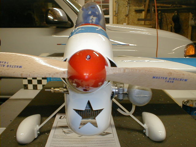

Just finished it up and will maiden it Saturday weather permitting.
Supertigre .90, 14x6 to start with and may try a 16x4/15x4.
7.1 lbs with a 1800mah nimh and CG at 5.5" to start with.
