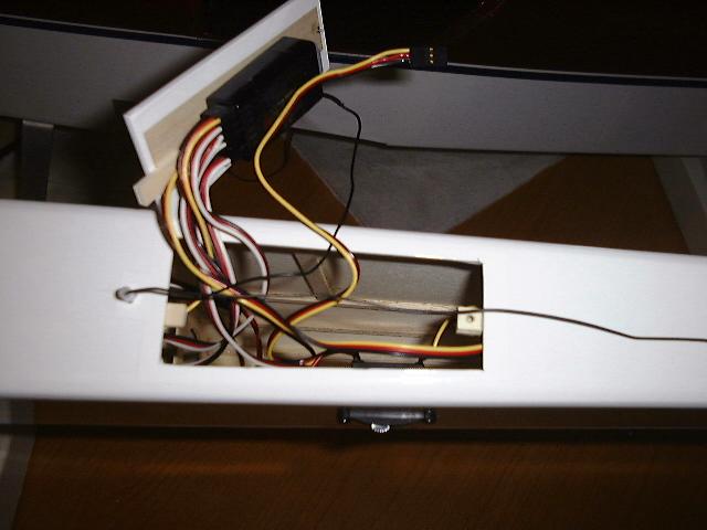

Hi Andy,
Here is a picture of the tank in my UCD which also is using a YS 91FZ. I just used a support against the back of the tank (to prevent it from moving backward) and one over the front (to hold it in place). I think that these pieces of wood were included with the plane (to hold the tank in the "stock" location?). Anyway, this seems to work just fine.
By the way, you will *love* the plane with that engine!
