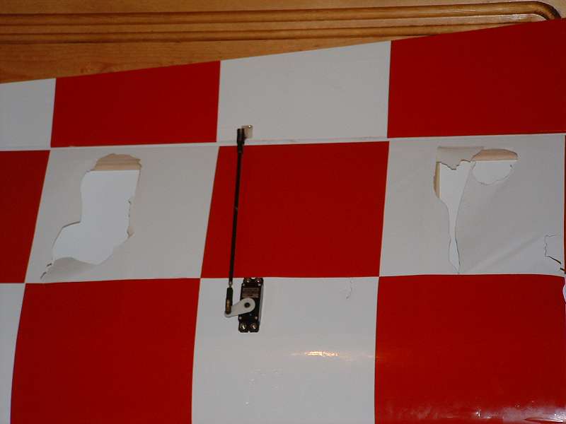

Well i guess i am out of luck.
the last two times i flew something messed up happened!!
good thing there cheap repairs though.
first hit a bush and poked a few holes.
then today flying in 15 mph winds i landed soft as hell on a ant hill and wham landing gear pops out and i got more holes in the wing!!
i will give great planes a thumbs up on there landing gear because if it was in there with epoxy or something to that sort i would probably need a new
plane.
the damn gear just popped out easy fixes
