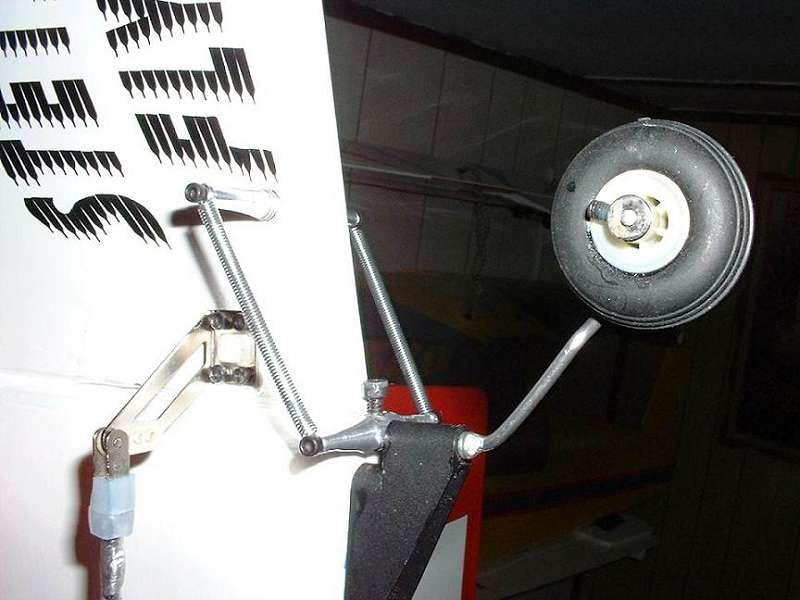

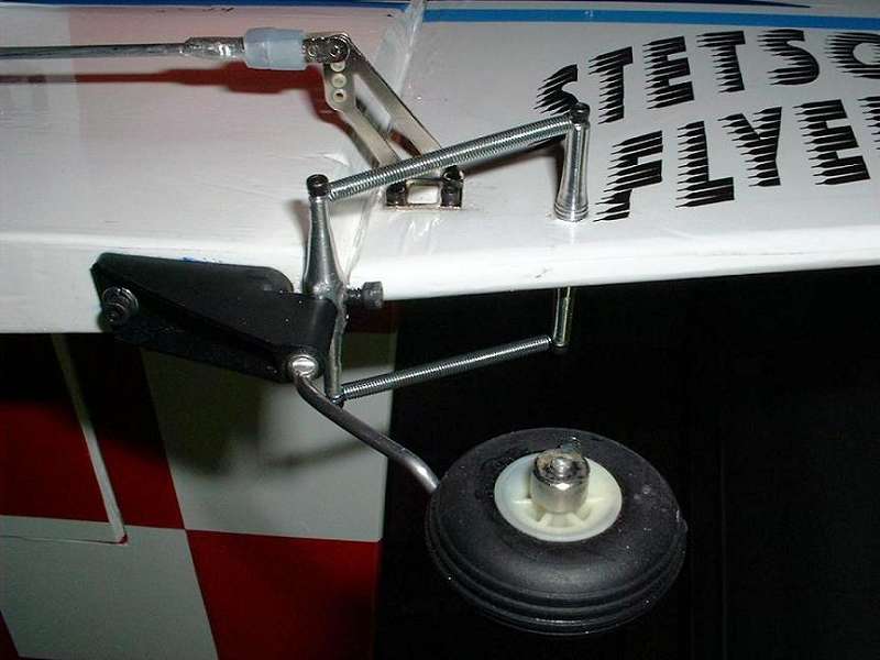

Hi Guys,
I never liked the idea of having the tail wheel rod glued into the rudder. For starters, the rudder always have to absorb the impact upon landing (hard on the rudder servo as well) and two, you cant adjust the tailwheel once the rod is glued in. Since I have my new metal lathe, I try to justify the cost and keep the stupid things to a bare minimum (hard to do) LOL
So for my UCD3D 60, I made my own tail wheel assembly. The aluminum is all hollowed out and the hex head screws have been cut with only about 4 mm threads to keep the weight down.
It seems as though I can't upload the pics. I am getting a message saying it did, but???????

On the aluminum tail wheel be careful using metal to metal have you ever herd of RF problems with rubbing meterals. It can key up right frequency it can screw up your radio in flight . Try to use a carbon fiber or plastic bushing to hold it for the axle. Sometimes good ideas need testing out . I am sure there is someone who can tell you better what can happen. I used a sullivan 60 size on mine works great Good luck show a pic when it is done SL

Hi SL,
I am familiar wirh RF noise. The control arms are spring loaded so there will be no vibration on metal to metal. I build and fly Giant Scale airplanes and have seen my fair share of RF interference and gliching. I have not had any RF glitches so far, knock wood, and try to do my best to prevent them.
Here are the pics finally.

Ok I see what you were talking about. I got your 1 St post mixed up without a pic. I was thinking you made the wheel hub and brackets out of aluminum as well. Nice job. I have a set of control like what you built from kankade on a GS 300. I wish I could say I made them I paid $$ for them. SL
