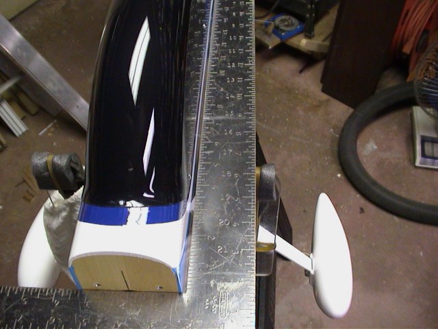

Originally posted by mecam
Right Thrust! LOTS of them, at least 4 degrees.
In a previous UCD post, rumor had it that GP had shipped some models with and without required firewall thrust angle. I also thought I heard some one else say that they had a UCD that actually had LEFT thrust angle built in. Well,... mine is an example of just that. Study the picture below. Looking at the picture, notice the gap along the front right fuselage edge and the inside transition of the T-square. The vertical edge of the T-square touches the fuselage further down the fuselage, indicating left thrust. I still need to add 3 washers most likely in order to get the required right thrust. After reviewing some video of me flying last month, I heard myself say a few times "Geee, see how it pulls to the left when I gun it!". That got me thinking.

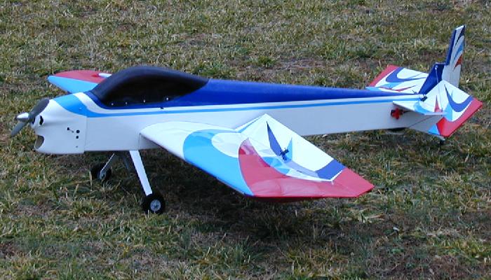

I maidened mine today, and all I can say is WOW, WOW, and WOW!!!!!!! My 80 four stroke is going to find a home on something else. It has over 1/1 power to weight, but just not enough for me to be comfortable. I have a 91 2 stroke on the way.
I need to add alot more right thrust, I think mine was one of the ones that shipped with left thrust. I may add a degree of downthrust as well. I think I am still a bid noseheavy (I estimate I'm at 5 1/2" right now.
The rudder on this thing is amazing. I think this plane will do a double hammerhead from hover to hover, with enough engine on it (Hope to find that out next weekend).
After flying it today, I am convinced the CanUDo3d is a dehydrated Dioblotin XL. It's just a shrunken version. They fly so similar, and so slow and manuverable. I would highly recommend this plane to anyone.
Here are a couple of pics from the field after the maiden.
GOT THROW?????
Steve

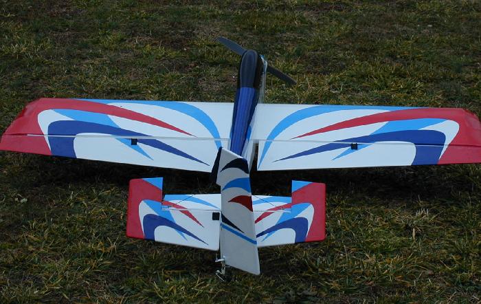

Did it ever waterfall, even without flaperons turned on. High rates are just a little lower than the pic, so they dont bind
