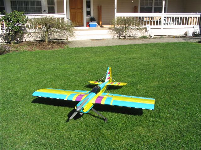

Co 16 Y I have my YS 140 on the Fun World 3-D I liked my something extra so much after 200 runs I sold it. I saw one like this at the club and had to get it. It is just like the something extra but with great tracking the slow inverted flat spins are sweet.

Gotcha SteveL. I guess I read to much into that. My jaw dropped when I thought you had a 1.40 in there. HA. I was going to round that back to all the firewall issues people had run into with this plane and ask what you did on yours.... but.. nevermind.
Fun World sounds like a fun plane.
