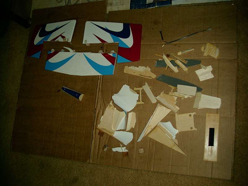

UGLY! Put it in hard today. I was putting along real easy and the horizontal stab flew off. I thought it had broken at first because I've read about that happening. I had no pitch control so I leveled the wing and shut the engine. It porpoised down and wouldn't you know I was lucky enough that it landed during one of the "porpoises" while straight down. Slammed the spinner into a rock. I took a crash site photo with a camera phone so it's not a great photo. The most sickening part of it? I think it was my fault. This is a new build so I've been checking fasteners for tightness. I've neglected this one and I didn't Locktite it because I wasn't sure if I could transport it without removing it. No more than 10 flights on it and I let this happen. Crap-Ola!!! Live and learn.

I&C, sorry to hear about your loss. I epoxied my stab with two long CF strips on the top and bottom of the TE. The bolted-on option did not appeal to me as I found the assembly not rigid enough.

Bummer, Its amazeing how they all look the same when the expiration date is up. If it wasn't for parts being on virtual backorder they're cheaper than trainer parts. Good luck with the fix. I noticed something of interest on the fuse where the hor. stab mounts. This model (#3) has about 30 flights with nothing more than floating to the ground on a very smooth runway. Stress? #1 and #2 resulted in nothing less than severe impact but the tails were fine. Joe
