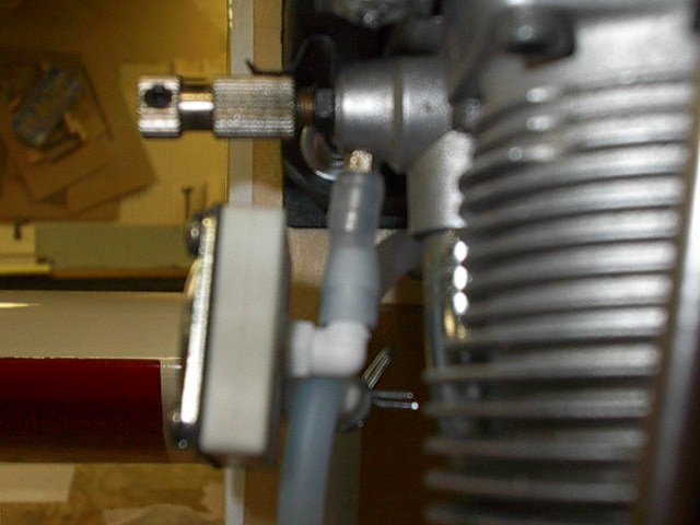

I have a question on the Cline, I have noticed that when I transition from high end to low, the low end seems to have to "catch up", it doesn't get to it's normal idle until it burns off whatever is in the carb, or so it seems. Is this normal? It seems to be creating a short hesitation in the engine.. I am running this on the UCD 60 with a Saito 100..
Also, thge Cline RULES!! I put it on, pressurized the tank, it fired right up! Turned out the high end 3-4 turns and it worked perfect. Made me laugh because another guy at the field with the same set up (no Cline though) did nothing but fiddle with his needle valves all day on his UCD...

I only got to run it up yesterday, but I did notice that after leaning it out and then backing off 3 or 4 clicks it put me right at the normal 1 1/2 turns. We will see if thats where it will fly at. Wondering if the pressurized system affects the low end setting? Joe

I am thinking that the fuel line from the out side of the cline to my carb may be too long. I made it pretty short, but it still may be too long. If you think about it, the longer that line, the more fuel there is after the cline stops pulling for the carb to burn off.. sound right?
Old 04-18-2004 | 05:58 PM
  #2091
coomarlin's Avatar
Posts: 1,015
From: Morgantown, WV
Default RE: U Can Do 46 and 60 prop/rpm
ORIGINAL: NOVAflier
That line should not be any longer than 1.5 inches. The shorter the better.

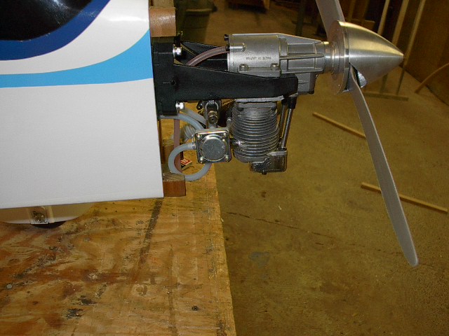

Here is mine, sorry for the blurry one. Maidened today. All I can say about the cline is, SMOOOTH. Unbelievable difference in performance. Regardless of tank position, I can see where all four strokes would benefit from it. Money well spent. Joe

Old 04-18-2004 | 08:30 PM
  #2093
STEVE LENZ's Avatar
My Feedback: (45)
Joined: Jun 2002
Posts: 392
From: Sammamish , WA
Amen to that Joe. I am having so much fun with mine with no dead sticks I bought a new Saito 100 and a Cline for a back up, I am looking at what is coming down the road In Arfs to install them. THE EXTREME FLIGHT 540 Edge 60 size will be on the market soon. As well as the Sig Mayhem ( NOW) may be a candidate for it. I like to see one preform first. OMP Yak 54 Is what I may go with. I may have to build the Yak only to match the weight of the U-Can -Do. Joe after 2-3 hours engine running time make sure you adjust the valves and give it a good wrench check out to make sure every thing is still OK. As well do it now ( NEW) and I bet you will find a motor mount loose. Or muffler that may need new Nylon tape installed. Just remember if you loose a carb screw or something on the engine - the turn around time to get one may be two to three weeks with Horizon. I may have to try and balance my tru-turn spinners because of you And see if I can get it true thanks . I may be asking you a few questions if I am doing it right? Seems like a plan. SL
