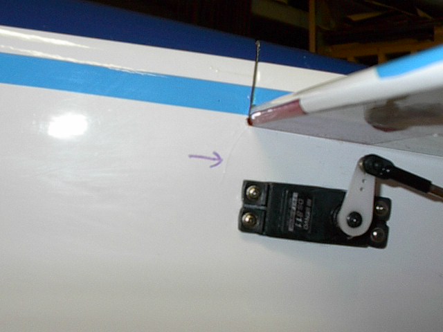

Posts: 2,279
From: Clarks Summit, PA
Anybody getting any cracks in the fuse sides, at the forward lower corners of where the hoizontal stab mounts? This is the second one it has happened to, both are second year production models. Seems like the first year had other issues, but this was not one of them. It dosn't appear that the light ply underneath is broke, just like stress cracks in the balsa sheeting and the mono bursts. Could be from running it down the strip on only its rear wheel. Its an easy fix, just curious to see if mine are the only ones. If I have to start tearing off mono, I might not stop and do a recover. Joe
