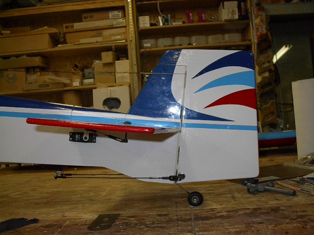

Ripper, this is the first in what could be at least one more mod to the existing rudder to see if I'm headed in the right direction before I finalize a new rudder. On this mod I removed 3" from the top or 19 sq. in. From the back edge of the rudder, I measured up to the top 10-1/4" then from the front, where the leading edge meets the horizontal stab, I measured up 1-1/4" Peeled the covering down to the first cross brace, fitted and glued in place the new ridge piece, or top rail, and once cured I cut off the unwanted part. Sand and re cover. The next mod will be to remove part of the upper rear vertical piece and reinstall it at an angle. From the bottom rear corner of the rudder, angled in about two inches from the top rear. The first mod brought the overall area down to 66 sq. in. I realize on the next mod I will lose more, but it is only a test for further direction. On the new one I plan to add about 1" to the heel of the fuse where the wheel mounts so I will be able to extend the rudder down another inch. At that point I will extend the width at the bottom by app. 1" That will result in more volume below the horizontal thrust line, where, right now is the area that seems to need enlarging. My goal on the new rudder is to keep to 60 to 65 sq. in.

Okay, here is the second mod of the stock rudder. It is now less 10 sq.in. from the first reduction of 19 sq. in. now totalling 29 sq. in. of area removed. This will be the last mod of the stock rudder and results will play a big factor in the new design. The 10 sq. in. was removed from the upper trailing edge, angled down to the lower trailing edge. The first reduction from the top eliminated opposite wing drop when rudder is applied and lessened the dive to the wheels somewhat. I'm curious to see if this mod will effect the wheel dive further. First pic is stock form, second pic is first mod of 19 sq. in. removed off top and third is another 10 sq. in. from the upper trailing edge.
The present 56 sq. in. tital area is below the target area on the new design of 65 sq. in. Hopefully the rain will let up enough to test it tonight. Untill then.......Joe
