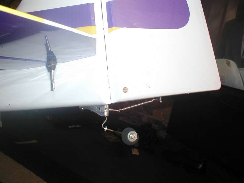

Here is a photo the modified tail assembly. I just shaped some small flat stock aluminum.This setup work well so far.

Also I am going to cut the threaded rod on the rudder horn assembly, because it seems to interfere with the elevator halves at full deflection. since the ball links are threaded in a bit this should be fine.
Thanks Woops for the upload instructions.
Gerry
