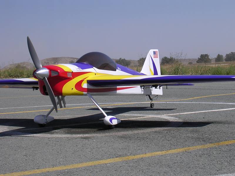

Hi fellas:
Some of mine at the field in cyprus: You will notice the american flag covers up the Mike McConnville Design stickers. I feel kinda bad about that (Sorry Mike), but couldn't find a more suitable place and it being close the fourth and all, I had to show the colors out here!
[img][/img]

isaacslaw ... She looks good.... I did the same with my flag..... But for some reason
unknown to myself I installed it blowing towards the front[:@]..
I asked for advertiseing fees... No answer....Sooooo
No problems with your firewall/pitts???

no problems as yet -- I dremmelled out the bottom one fourth of it and it is exposed to the air -- I am still concerned about it but put a layer of glass cloth down in the front of the compartment -- the YS kept cracking the wood there from the vibrations. The glass cloth added much stability and so far, I have not seen fuel in there at all. The pitts sounds really good with the 110 -- kind of like a nascar type thing, but I think that might just be my enthusiasm
