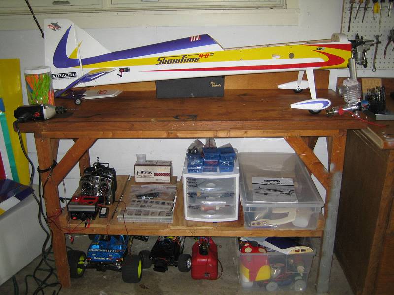

I recently got my Showtime finished and I am running a Saito 150 in it. Mounted up with no problems using the stock blind nuts, I had to shave the mount a little to fit the crank case but no big deal and a small notch in the firewall for the muffler in which i put a block and shaped it out so it is still solid. I have Hitec 5625 digital and a 5645 digital for rudder with a 2700 mAh NiMH. I put the rudder servo in the tail and the receiver sits next to the throttle servo with the batter right behind the wing tube on the CG. Awsome engine for 3D, looks and sounds cool and all the power you could ever need, it will yank right out of a hover without hesitation! Walls are straight, wing rock is minimal until established in a harrier then it goes away, parachutes are smooth with no rock.

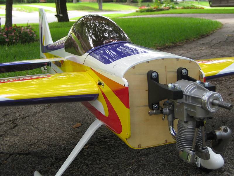

Just got back from out of state. I was able to work on this plane for about 2 hours on the 4th and I just got finished mounting the engine this morning. This plane is really sharp looking. Everything was in perfect condition when I got it, just a few wrinkles on the covering.
There was only one problem. When it arrived it was missing 4 of the nuts that secure to the controle horn bolts. The plane was supposed to come with 6 of them but it only came with 2 so I did the ailerons. Home Depo didnt have any bolts that would work so I just ordered some from Horizon, $10.
This is going to be a real easy build but.....
Got one question for you all:
Are there any pictures of the cowl cut-out for a saito 100???? It would be a nice starting point in helping me see where it needs to be cut. The instruction manual's way is nice but I personally think it is just easier to cut and see if it fits, then cut some more and see if it fits again.
I mounted the engine as far foreward as I could, I thought it would help with the CG, it will still fit in the cowl though.
I know its underpowered, thats why I bought that DA 50 in the picture there, If I dont like the saito I will just swap them!
I am going to mount the fuel tank back up against the with tube. I dont know where the battery needs to go to give it the correct CG but I hope it can mount on that mounting piece of wood for the original fuel tank.
