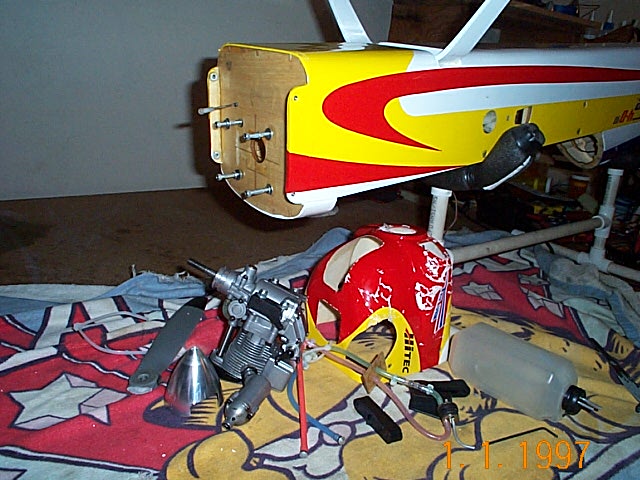

Hi People.. Had a good morning until
I had been flying the S.T.... All was going great, on the 4th flight I was doing some hi
speed blenders, mad it was crazy, got a lot of ooohs and ahhhs... on the last on i came
out into a K.E. I then started doing touch and goes(2) from my end of the runway then
one from the other end, all was going just great as she was coming towards me I thought
I'd try (a first for me on the S.T.) a low hover after lift off, so I let her roll on the runway
to me, but it started drifting towards the fence, a I added some rud. nada.. added more
nothing, I should have figured it out then and cut the throttle, But No... I look at my radio
to make sure I'm moving the rudder[:@].. Yep. stick is moving, but nothing, but the fence
is right there now.. I hit the kill, but too late, into the fence she goes[:@]
To my surprize not much damage... A broken mount, cowls a bit torked and scratched, but
can be reused.. So far thats all I can see wrong, I thought for sure the firewall was history,
but it looks good... I did get fuel in the belly[:@] as it crack the tubing at the fuel nipple and
the old YS pressure pushed some fuel out, but it got cleaned out pretty quick. At home I
used some foaming carpet cleaner then wiped clean and letting it dry out.. Hope that works..
Guess the engine mount is just the standard hangar9 90 sized mount??
Ohh... A backed out srevo arm screw started all of this, I checked all before the first flt. and
all was good and tight... Guess I'll use "more" loctite next time, this is the second time that
screw backed off just far enough to let the arm slip off the gear.. I put just a small drop after
that... I'm coating all of it now.....

locktite on all linkages is a must. I also learned the hard way after my maiden when i relized that i lost the servo arm screw on my MG servos and a few of my screws has backed out on the linkage itself.

I hear you on the loctite.. I use it on almost all, but had a small problem with it on the
servo arm, I do check all at the start of the day, and since this was the second time that
the same screw backed off, I did use a "little" loctite... I'm coating now!! But the thing the
gets me is I said that I would check all the screws every third flt.... This was my fourth[:@]
And the other big thing... If I would have just killed the engine instead of keep trying the
rudder, and after twice moving the stick, looking down at my radio to make sure
Ahhhh The brain plays funny things at times.... Damage is super light, I may fix the cowl,
but at $13 I think I'll just get another......
