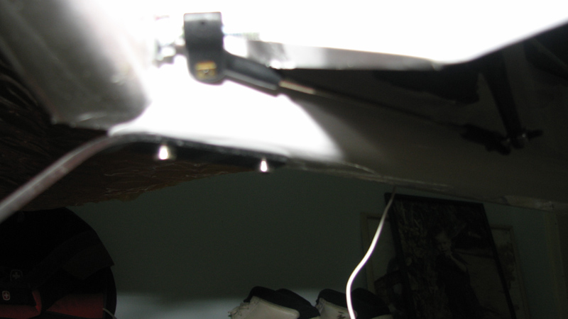

anyways now i have a new problem- i'v mounted the rudder servo in the back and now the elevator is toching the ruuder pushrod when they are both in full deflection. the problem is that if i reduce the deflection of the elevator so it wont toch the pushrod i dont have enought deflection for some extreme 3D wich is what i'm going to do with these plan. do you guys have any idea what to do in this situation?
thanks again
d_b

My Showtime was from the first run of kits and my rudder horn hole is drilled lower than what is in you picture. The nut washer is very close to the rounded part of the rudder. Mine misses by 1/8 inch at full deflection. I would just plug & re-drill the threaded rod hole. Should be a quick fix.
