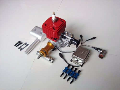

Yep, and for the price of 1 Evolution, I can have 2.5 CRRC's!

I've tried APC 16X4-16x8-16.5X5 / XOAR 18x6 / Master Airscrew 16x8...basically, whatever was in the garage. The max rpm I got was with the 16x4 @ 8,900. The 16.5x5 gave the most thrust. Hovering was done just under full throttle and there was a teeny bit of pullout or none at all.
I've seen your vid. and it looks good, but I'm not geting those results. My engine is fully broken-in and running great. My dad wants to use it in a biplane, so that's the main reason I'm switching engines. The CRRC is only slightly heavier, but it puts out oodles more power.

What are the specs on the CRRC?

I copied these from prcmodel.com
SPECIFICATIONS:
Type: 2 cycle piston valves type gasoline engine for airplane.
Displacement(cc): 26cc
Bore x Stroke(mm): 34mm*28.6mm
Dry Weight: 1.165kg/2.56lbs. (With standoffs, muffler and CDI)
Carburetor: Diaphragm butterfly valve type
Maximum Output: 2.42 hps/7200rpm
Speed range: 1800-9000rpm
Ignition: Auto-advaance DC-CDI
Iis-Ignition: 4.8V DC
Gasoline/oil mixture: Pre-mixed Fuel, 40:1(25:1 for break in)
Lubrication oil: 2 cycle engine oil
Propeller: 16 X 8, 17 X 6, 17 X 8, 18 X 6
Cooling System: Air Cooled
