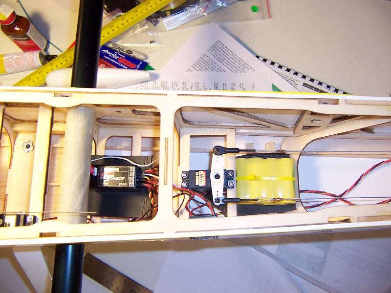

looks like I am having a problem. Tonight I tried to finalize it and run it up. As I attached the canopy I noticed 3 of the 4 screws dont line up. hmm..looks like I will be calling H9. I might try anothre solution but I have not figured anything out for it. Im also a bit dissapointed, this airplane went together brutifully
here is a pic of my "guts" got the cg at 7 1/4 as well
matt

you really need only 2screws to hold that thing together. So I woulnd't stop a maiden just because of that

Mine did the same thing.. I forced a line up. after first day of flying there was so much force on the screws that the vibration from my motor popped the aluminum angles loose. when i glued it back i did the alignment myself by bolting it on while epoxy dried and problem was solved ( dont use too much epoxy or it will glue the canopy down to the fuse)
thanks for the info Lee
I thought about cutting the metal guides off and realigning them myself but I ran into a quandry when i tried to figure out the best glue to put them back together. JB Weld?
I can force 2 screws to lineup but thats it and I know I am going to have the vibration issue as well. *sigh....*

Can't you slighty enlarge the holes on the fuse. Mine were off (low) just a little and that worked for me.
Also, use nylon screws to avoid vib. problems. I believe they are 4-40s.
Good Luck!

I considered enlarging the holes but I was concerned with the screws then moving around the larger hole and causing it to route out even larger with the vibration. I will see if I can find some 4/40 nylons, not sure if the olhs carries those

but after only 2 flights, 2 of the hatch/canopy screws (mine lined up fine) were gone....
they were in tight, but the vibration knocked them out.....
would the nylon bolts help?

Trust me guys...Go Nylon!
