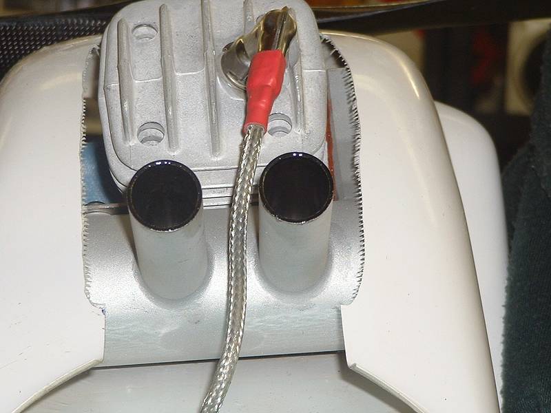

i have the matt chapman 1.20 size cap with a da50 in it it needs the nose wieght to balance i had a os1.60 in it before and it needed a pound and a haft of lead to balance at 5-5/8 c.g. the plane fly great with the da the cap had no poop on hot days with the 1.60

also i have the kangke 1.20 size cap i had the brisson 2.4 in it pulling a 20x8 prop it had no balls i have a zdz 50 in it now and it is great

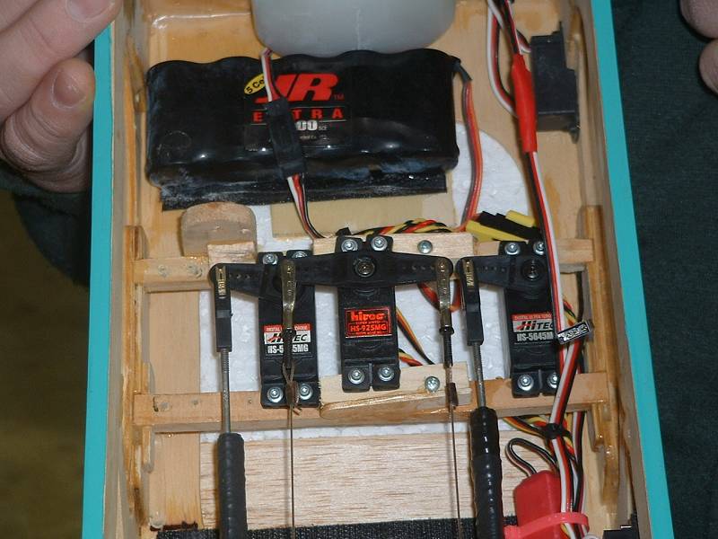

FLYGUY GOOD LUCK TRYING TO GET 13 TO 13.5 LBS YOU CAN TILL IT COMES TIME TO BALANCING THE DA50 WILL HELP PUT THE BATTREY AND IGNITION BOX ALL THE WAY IN FRONT PLUS I HAVE A MINI SERVO IN FRONT NEXT TO THE GAS TANK FOR THE THROTTLE GOOD LUCK AND HAVE FUN THE PLANE IS A BLAST
