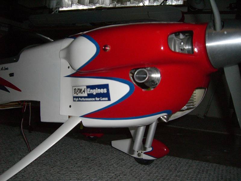

I know just how you feel. I started mine out on the 160 and then switched it over to a BCMA 40cc because I also wanted to try gas. It's really not much trouble to do the swap. With the gasser I got to put all of the servos in the tail where I wanted them. A 50 would really rock this plane but the 40 flies it very well also. Good luck with your conversion and if you need any help shoot me a PM or e-mail. Bubba can tell you anything you'll ever need to know about this plane and a gas engine also. Good luck!!

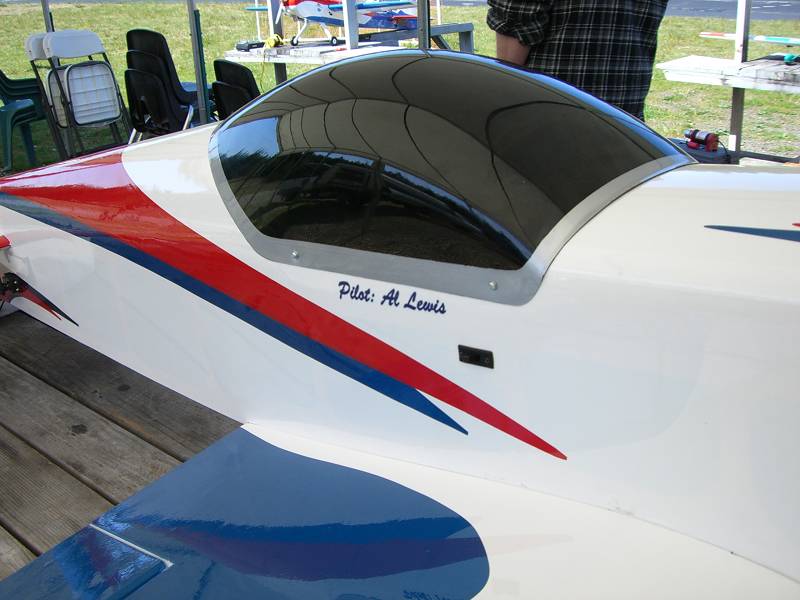

Yeah, the Wild Hare Edge has a 7 foot wingspan and is much larger then the CAP when setting side to side. I've read several comparisons on here between the DA and the 3MM by guys that fly DAs and they all love the 3MM. When the new BCMA 50 comes out next month I'm going to pick one up to try out but, at the moment, I'd say the 3MM is the best deal out there I know of. It hovers my Edge at 1/3 throttle. BTW Here's a shot of the 3MM in my Edge and a preview shot of the new BCMA 50 due out next month.

Flew the CAP today with a Xoar 20X8 Beech Ply prop turning 6600rpm with 19 pounds of static thrust. Plane hovers at half throttle with power to pull out of a hover slowly. Keep in mind that this engine is not broken in yet. I think if you want an engine to pull out with the kind of authority you're looking for you should go to a 50. Just my opinion. Once broken in, I'm sure this engine will pull out of a hover nicely.

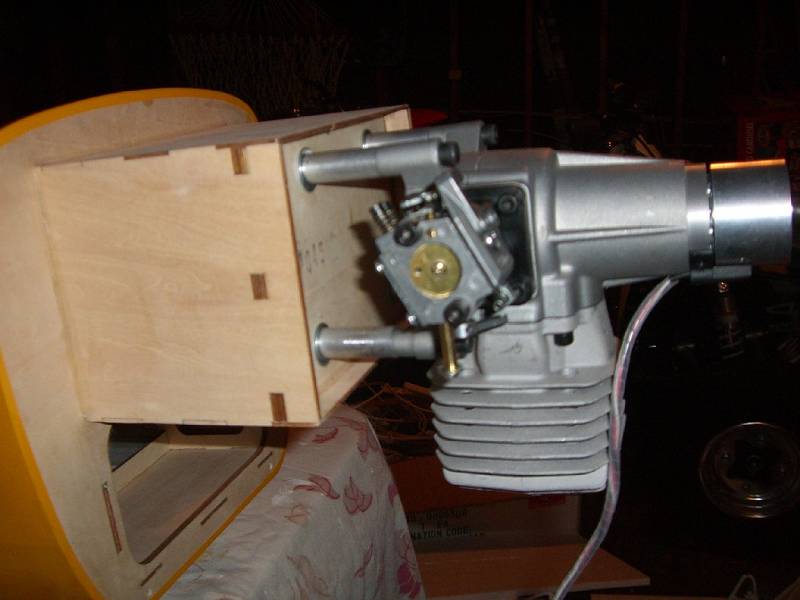

Well, forget the ZDZ for my bird due to deal gone bad. It just never showed up and the seller isn't responding. However, I have in hand a BME 44
. The really cool thing is the way it mounts. It uses the same mounts as large two or four stroke engines. I held it up to the mounts on the plane and it looks like it'll drop right on with only a slight amount of adjustment of the mount and a hole in the fire wall for the carb. One question, will I need to do somdething to direct air to the venturi or will it get enough from inside the motor box? Would holes in the side of the box be enough? I don't want to weaken the structure too much. I've been putting together my new C.G. arf Sukhoi but now that I have this it's on hold and I'm back on the Cap
Work has been brutal busy but with enough evening time I hope to put'er up again this weekend.
All you gasser guys jump in and help this rookie!

You should have at least one half inch between the carb and firewall, more is better if not cutting out a hole for the carb. Or just cut a hole that is the same size of carb's venturi in the firewall directly behind the carb, usually a one inch diameter hole will be more than enough

Bubba, Flew the CAP last weekend with the 40 and a 20X8 Xoar prop turing right around 6700. When I put it into a hover it wants to pull over to the left every time. Do you think some more right thrust would correct that?

Yep...I'll bet on a long upline it pulls hard left near the top if not before and possibly towards the gear which would indicate too much downthrust as well.
Get the lines to go straight and the hovering get tons easier.
