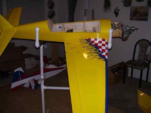

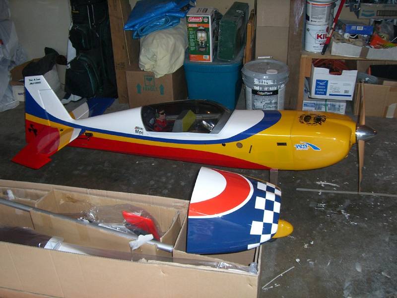

. I used the BME 44 on the 260 so I've decided to put an O.S. BGX-1 3500 on the Cap. It flew the snot out of my W.M. Extra 300 but it's down for a major recovering job. Ran it into a hole on taxi back to the pitts and knocked the gear out of it so no better time than the present I guess[:'(]. The good thing is my wife has been helping me with the project. We're sort of ripping off the BVM 2.6m Edge fantasy scheme. It's slow going at best but a fun colaberation. I'm looking forward to getting the Cap in the air with the BGX. It's a soild engine that already has all the tweaking done. Hoping to maiden the 260 and the reworked Cap both next weekend. I ordered a virtual cockpit kit for the 260 and it should be here tomorrow and it's done when I glue on the canopy. The BGX is mounted on the Cap so I only have to plumb it and rerbalance and it's ready(work permitting, of course)[&:].
Check out the pics of my(and wife)first full cover job[8D].

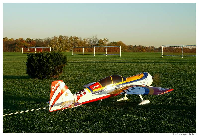

I actally had a similiar thing with Brad. He cut me a set of graphics for my Yak (It's on his web site) and he noticed I stuck one of them (The Yak logo just in front of the canopy should have went on the turtle deck) in the wrong place. He sent me a new set them called me to tell me he sent the new set. I think my jaw dropped to the floor.
I've been using him ever since. There was a period where he was hard to get a hold of but he's back in full swing doing graphics pretty much full time (he does have a day job) and usually gets them out in a day or two.

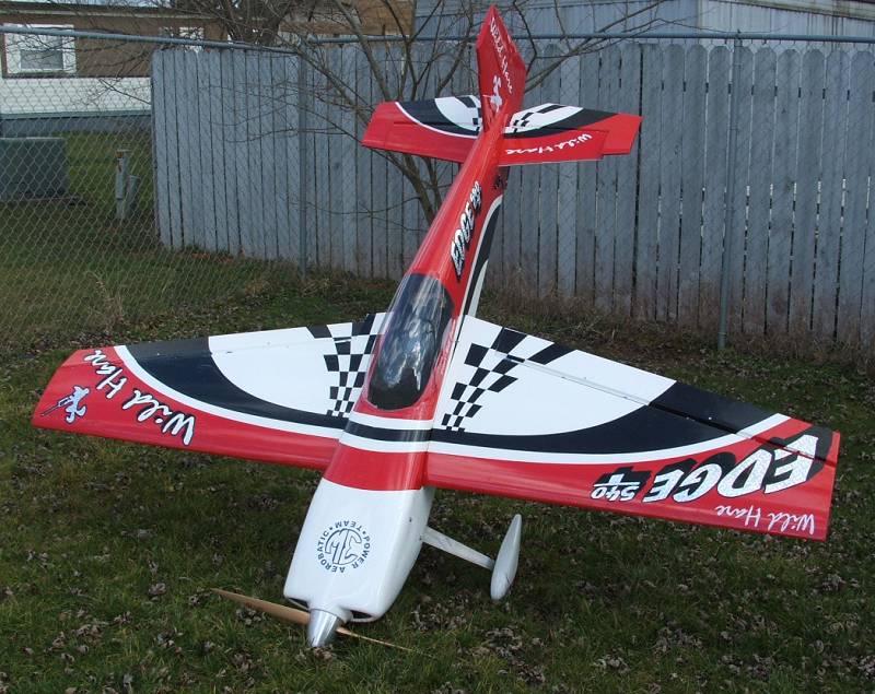

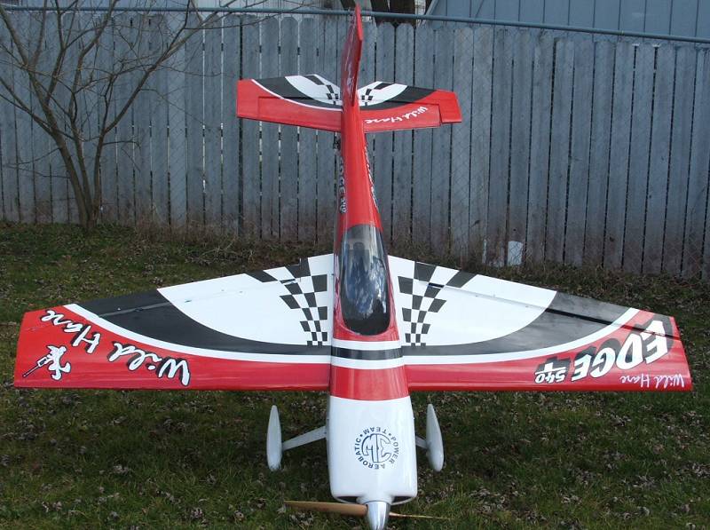

Here is the WH Edge he did for me. All graphics are in hologram though the camera does a poor job of showing it. He also did a set for this Cap but I do not have pics for it
