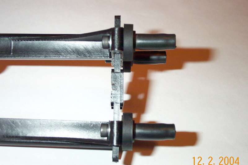

I tried out the IH anti-vibration engine mount, I swear they have given me short bolts to screw it to the firewall! Arrrgggghghh! Now I need to go to the ****** shop to buy some more, Ah well. I need so many little things its annoying.

Default RE: Capiche 50
No, they are def for the firewall, I may be an idiot but I am not THAT stupid. The ones for the engines are nylon m3 I think or something like that.
Well I don't feel like building anymore for some reason, its not the mount its just frustration for some reason, hmmm, well, I might get the tailplane/rudd done soon which is the easiest bit so far, I am not looking forward to the wing.

Shahid, the bolts are only just long enough to start with but once assembled are fine. You have to put the bolts through the mount and into the rubber section BEFORE the parts are fitted to the bulkhead. Even like this you may have to give the rubber nuts a squeeze to get them started on the threads.Only wind them on about 1 turn before then feeding the rubbers through the holes in the bulkhead & then tighten them up.
Jim
