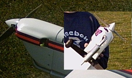

as you can see in these pics i have the cheeks cut at the rear, also at the front. and a O around the pipe which then leads all the way back a little thinner so i can take the cowl off with the pipe in place. so more of a lollypop shape.
unlike the D it doesn't really show and to me looks better.

That settles it, going to cut out the back end of the cheeks. Watered down epoxy sounds interesting, its def fuel resistant but when I get to covering would the covereing be lumpy where Ive epoxied? I plan to fuel proof firewall, around the side front and bottom and top front.
