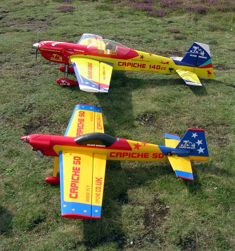

NOW ITS BIGGER....... now its not..............
ID:	155258   Click image for larger version

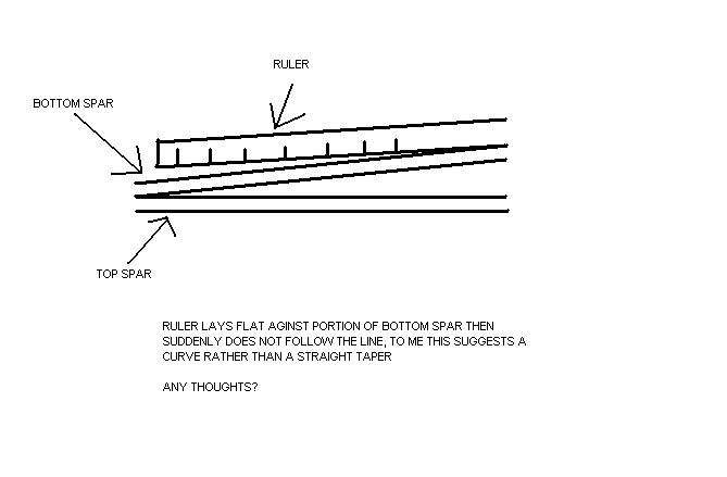

Well im building the wing and pics to come soon but I think I will stop where I am (gluing false trailing edge WST) because I still aint happy if it straight or not, it seems straight and the board checked out but I still aint 100%, any tricks for finding out if it is or not? Thw top of the wing is flat to the board and when I put a long metal ruler against the bottom spar it didnt lie flat???
Shahid
Old 07-28-2004 | 02:48 PM
  #3944
Joined: Feb 2003
Posts: 515
From: o, UNITED KINGDOM
Default RE: Capiche 50
Shahid it wont!!!!!!!!!!!!!!!!!!!!!!!!
The wing tapers Just build it
Old 07-28-2004 | 02:52 PM
  #3945
Shahid's Avatar
Joined: Dec 2003
Posts: 1,538
From: London, US MINOR OUTLYING ISLANDS
I may have misunderstood you here Malcolm I know it tapers wing section thickenss wise (thats where it gets dihedral from, right? The variation in thickenss&gt but if its a constant reduction in thickenss towards the tip it still should lie flat on the spar? I will have to show you guys a pic.
Ok this aint the actual pic but its a quick drawing I snapped up
The ruler lies flat for a portion then it all goes miffy
Old 07-28-2004 | 05:03 PM
  #3946
Cactus.'s Avatar
Posts: 6,136
From: CamborneCornwall, UNITED KINGDOM
the top of the wing is flat, the bottom aint.
theres very few people in the world that would even notice a slight difference even if yours is curve, not straight from root to tip.
Old 07-28-2004 | 05:58 PM
  #3947
Shahid's Avatar
Joined: Dec 2003
Posts: 1,538
Ok so it does have a curve then GOOD PHEW
I was thinking that it had a constant tyaper not a curve interesting, I was just thinking twas warped. cheers phil.

Baron - does the 50 have the same section throughout the wing.
Old 07-28-2004 | 07:12 PM
  #3949
Joined: Feb 2003
Posts: 515
YES ish !!
Same section but it morphs in thickness.

i meant I'm not sure it has a curve persay, but to get all things right the top of the wing is flat, the dihedral is made by the angle on the bottom, it shouldn't matter if this is straight or curve flying wise, if the top of the wing is flat then due to the excellent CNC work the bottom WILL!!!!! be right.
unless it's the FF wing
