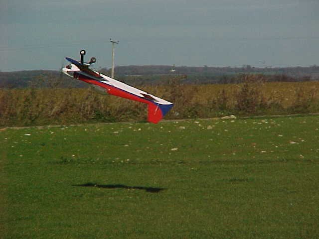

Kane: thats dave wilshires (i think thats the guy) C50? the on he did for the review for RCMW.
i got 2 short vids today, one 25 seconds me doing a low inverted harrier (which wobble lots less than upright) and a KE pass, but the cams got no zoom on camera mode so they seem distant, but they wernt. im trying to upload them somewere.
Foof, yes the cowl is on, but note the cable ties for the UC
this plane is so good to fly, i could not not fly it, so after the sellotaped UC, it was cable tied, hand launch, very soft harrier land
Ian[&:]
