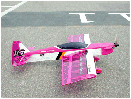

Already have a "Flubber" on order
Flitton site??? Come on post a link??
Going to fit a hacker b20 18l and a kokham 340 3s 3p pack. That will make the little darling have it
