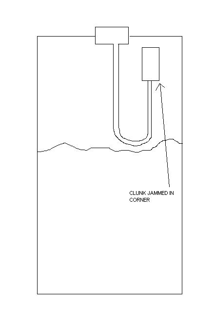

JEN 56 starts after some coaxing idles nice and happy......top end. WHAT! To cut a long story very short, crap loads of air is getting in the feed line, meaning as the plane is nose up an air bubble sooner or later hits the carb and thus fuel flow is inreupted and engine cuts. Need to chuck the basterd filter away and change the lines...

Well Im not rushing anything. I had a go at remvoing the tanl. Because its a 10 oz, it was a very tight fit in the fomers. I trimmed the farmer and it does slide. But the problem is I cant get it to slide out, theres not enough space inside the fuz to grab it properly and my fingertips just slide over the plastic! Of course I could cut the covering but eff that!
I am going to remove the filter and see what happens.

Ok, I cut out the covering to get to the tank and heres what I found.
The diagram shows what had happened. So as it went vertical it was drawing air, good for CO2 motors but not much else.
Also:
1) The carb line had cracked big time
2) The exhaust line had gone rip as well
This meant that in a dive or any nose down manuver fuel dripped out quite alo, as well as more air getting into the carb line. I tested the tank before I shoved it in again and it seems ok. Hopefully should't have any major probs........yeah right [X(]

Shahid couple of tips you may find useful. use a sharp blade to cut fuel pipe ratherthan shears or scissors as it helps to prevent splitting, and a loop of fibre reinforced adhesive tape around the tank forming a tab at the back gives you somrthing to grab when trying to extract tank.

Dave theanks for the tip. Ill try that tape method (why didnt I think of that)
