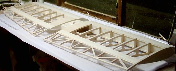

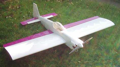

no problem, i was wonder how long it would take after i sneaked in a pic a while ago. i gaveup and had to slap you guys with a big wet fish till it got noticed.
I think it's a winner, and i'm not the only one, Christmas might come earlier than you thought Archie.. this isn't a fly by night thing i did.
i've taken shots along the way and a web page is on the build as we speak.
flight report. DAMN! windy, i needed to put in some down trim compared to the other wing ( think i got the engine angle wrong when i put it back after doing the graphics ) on KE i don't notice any roll, but it does go towards the wheels, nothing i can't hold with stick, nothing i can't program out, nothing i cant really blame on the extra down thrust, noting unexpected with a more draggy low wing. stabilty is great, roll rate good, it still looks great, transistion into hang is much easier, waterfalls are even tighter, the harrier isn't as stable as before, the wing keeps trying to fly, but less wind, less elevator and we'll see what we have. the elevator is VERY powerful now. walls are like you've hit one, might be the CofG too farback, but i have it kinda far back on the other wing too, i also have heavy ailerons that dont help, the wing is over built in the center and the heavy ailerons only add 6oz to the AUW over the other wing. she was flying backwards yesterday, and when landing at 0 forward speed jumped up 6 feet when i pulled back coz it wasn't done flying.
Choppy had a go and said it's great, TR and hangs good, just need less wind to find out for sure.

LOL I managed to miss it, despite the picture and the 'look what it did to my wing comment' !
well done, the rectangular wing looks odd to me, but thats probably because I have been conditioned to see the Capiche with the existing wing.
Whats the complete weight of the model with the fun fly wing ? What engine are you using ?

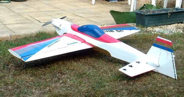

Whilst Im typing, thought I would mention I had another pic through from another Capiche 50 owner and I liked the simple yet effective scheme so I thought I would put it up here.
He said
"It flew very well , flies clean and accurate . Vey responsive control surfaces on low rate."

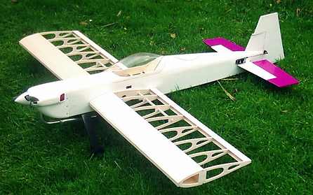

my standard dry weight is 4lbs 15oz with a West 50, don't ask where the weight came from, i don't know, i even have a mini throttle servo. i'm at 5lbs 5 oz with this wing, the loading is real low.. i had my doubts over the wing section, it was going to be Hypeish, sharp LE and high point further forward, but this wing is ok so far, no complaints.
KE is very good considering it's a funfly, and i think half the trouble is my CofG and downthrust, inverted and full throttle i bunt lol all easily sorted with a allen key and a shift of the batt. i do have two seperate memorys for each wing, but so far i've only taken the elevator expo to -80%, thats the only thing i change other than the wing. couldn't be simplier hey
the wing really doesn't look out of place once you get going, it's lacking the graphics right now ( doctored that other pic ) but now i'm happy i can get some made up.
yesterday i was quite happy throwing it around in the wind, i was the only one flying coz the rest did'n't like it.. think i'll leave the other wing for the nice weather when you can do good pattern, this wing is for fun and when it's rough.
one club member is sold on the plane now hes seen both wings fly.

my centre section is a bit different, it was trial one, and not as simple as it could be, together i think we've got a perfect double brace sorted that the other wing simply slides on/in to sorting the dehideral at the same time.
wether it looks like the thing i was thinking of when i badly described it to Malc i dunno, guess we'll see
