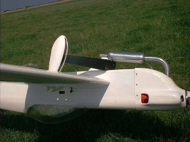

i took the ATV's back to 100%, same horns ( ie more throw ) took expo down to 40% and it's just about right, Choppy thought so too, the 12.25x3.75 certainly worked better in the hang not enough elevator to come from low pass to hover, maybe CofG too far forwards too, but everything felt crisp and good. Only problem........
came in harrier after harrier, all short of the patch so didn't land, last one ( as you do ) came in perfect, slow descent, angle right for a 3 pointer, blip of throttle when it was about to touch and a lould crack followed by it sitting a bit low on the deck. moral of the story is, don't Harrier with plastic UC bolts, and if you have metal, makes sure the grass is short and your glue strong. Surprised by these spats too, i have bits where the gel coat came off and the fibre is unepoxied. should be able to glue them back together. cant do much about the large dent behind the UC plate.

Oooooo, its gone strait through the wing. Who does that remind me of...............o, i remember, ME!

Oh No!!!
At least it is repairable.

Very much, gonna take the wing out into the garden soon to cut the scrap and prymol it, then recover those patches.

philly... if you had long grass then you should not have attempted to harrier it...
at this size the model gets an urge of forward speed just before it hits the deck.... what did you expect ?
