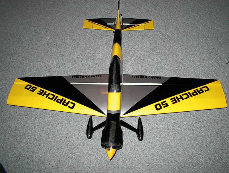

Hi everybody, I'm still here, just been real busy at work and doing the plane in the eves.Anyway here are a couple of piccies of it in its present state. As you can probably see its all finished and fitted apart from the motor,mount and tank.This is coz instead of my Lazer it may be getting a YS now,depending on a deal I may be doing with IH ( give Peter a nudge for me will you Archie,thanks).
Anyway, Let me now what you all think...like,hate etc, Ican take it[:@]

jimbo,nice one,thats the best scheme ive seen so far[8D],all those colours blend well toghether and the carbon parts,thumbs up

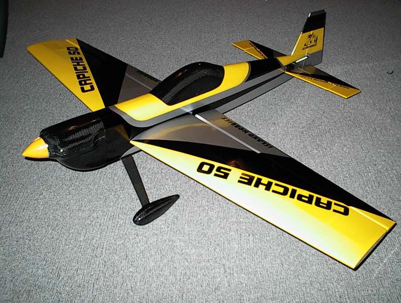

Cheers for that.Heres another.

looks pretty damn groovy to me. whats the bottom like?

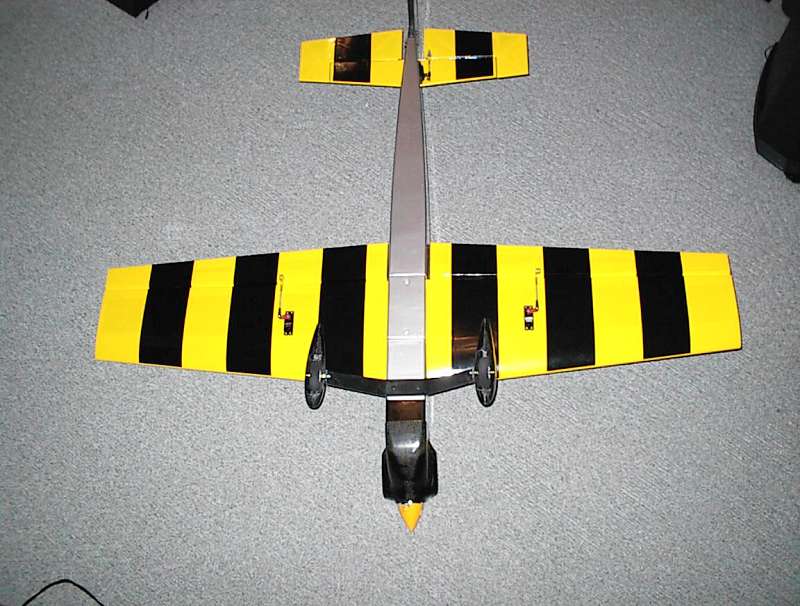

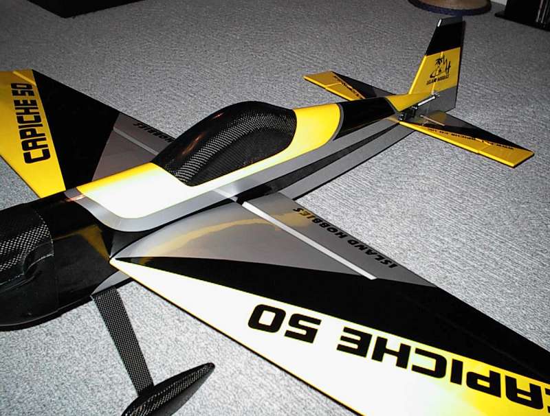

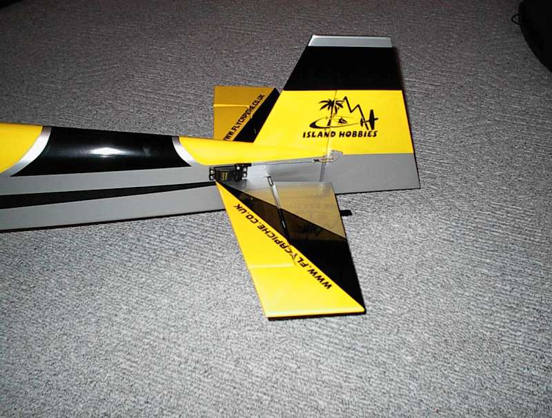

And a few more. The underside is Sprink style! The same colours as the top but visually very dif'rent, I hope! when exiting spins and tumbles.
By the way,I got all the accesories on this from IH....Axles,wheels,hinges,3mm pushrod set,heavy duty servo horns etc etc.And no I don't work or have any connection with them other than being a customer.

Thats what the bottoms like Phil. I was compiling the last post when you asked!

I really like the top half - clever use of colours with the carbon parts. Very sexy.
The underside doesnt look right for the scheme. Just my opinion though.

Looks fantastic Jim
Shame you missed out on the best dressed Capiche comp, I think you could have won with that. I may have to do something similar on my C140 when it comes.

Damn thats gorgeous. Id say thats one of the nicest ive seen so far. i agree with ultimat. The top is nice but the bottom doesnt 'match'. Was it based on Mike mcConovils extras and ultimates?

LOVE IT JIMBO !
BOTH SIDES ! I like models that look totally different one side to the other.... Would never have been my choice of colours but you have made it work REALLY well..

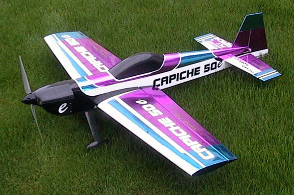

I dont like carbon comp parts in some ways- like cowl, but with the way you have done the scheme it really works - I tried doing the same with our elec one which is OK but not as nice as yours. see ours below

I do like the composite weave patern. It looks very very nice. But its a shame then, IMHO, the Carbon Copy products aint that good. Its quite hard to blend into a good colour scheme. I dont like what paul skinner did and he had a nice coulour sheme and stuck a black cowl up front. Looked terrible[:'(]

i never liked the stripes, but for this application it does work well and does exactly what it needs to, very stunning in these colours...
Would agree on the CC spats, a bit weak, but.. probably not made for grass fields.. still have to put mine back together for the 3rd time, thanks for reminding me lol

Jimbo.
Very Tasty
Love that look. I assume it's Profilm????
Like the way you've worked the cowling into it!!!

Ultimate.... I know what you mean about the underside, but I racked my brain trying to come up with an underside scheme that was chalk and cheese compared to the top, but without introducing any more colours as Iv'e been down that route before. I couldn't come up with anything that had a higher contrast to the top than this, so it won!

Archie... the "bits an bobs" meant I trawled through the I H galleries and I certainly spotted your leccy one, and got ideas from it such as the black front to match the carbon and the rear decking.I know I gotta wait for the YS delivery now anyway, so as long as we sort something out before then,and I dont get swamped out under all the C140 pre orders!!!
Philly...I fitted my spats to the uc with a small bit of wet and dry cyanoed to the Uc.Grips the spat and stops any swing( done it before an it works great).Also the IH axles are just the right length that the end can be made to touch, and fixed to the opposite side of the spat, giving much more support and less chance of buggering up,I hope! I fixed it with thick cyano and zapper, so that its got a good fillet between the axle and spat.The spat is really held on now,flexing it sideways just causes the uc to flex.
Its covered in profilm, with approx 5 mm overlaps on all the joints.Glad most people seem to like it though.

mine also have wet and dry, only not cynoed, i have a slot the spats sit on and then the bolts tightened squashing the spats between large washers and the wet and dry.
unfortunately because the inside is cut [:@] they sit too low, not only for what i prefer as looks, but for the grass.
the sides also arnt strong enough. ok i did have a twist edge washer on before that cut through after a few landings. after the landings they've had i expected more strength, the joint for the two halves is extremely weak.
i'm going to lay a bit more cloth and epoxy inside, the amount that should have been in there the first time. ok they will weight a bit more, but they should last more than 5-6 flights now.
The spats are a must for the look, even if they are just £21 sacrificial items for that first good photo
