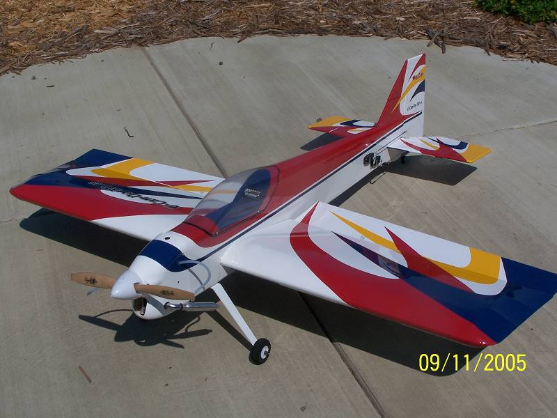

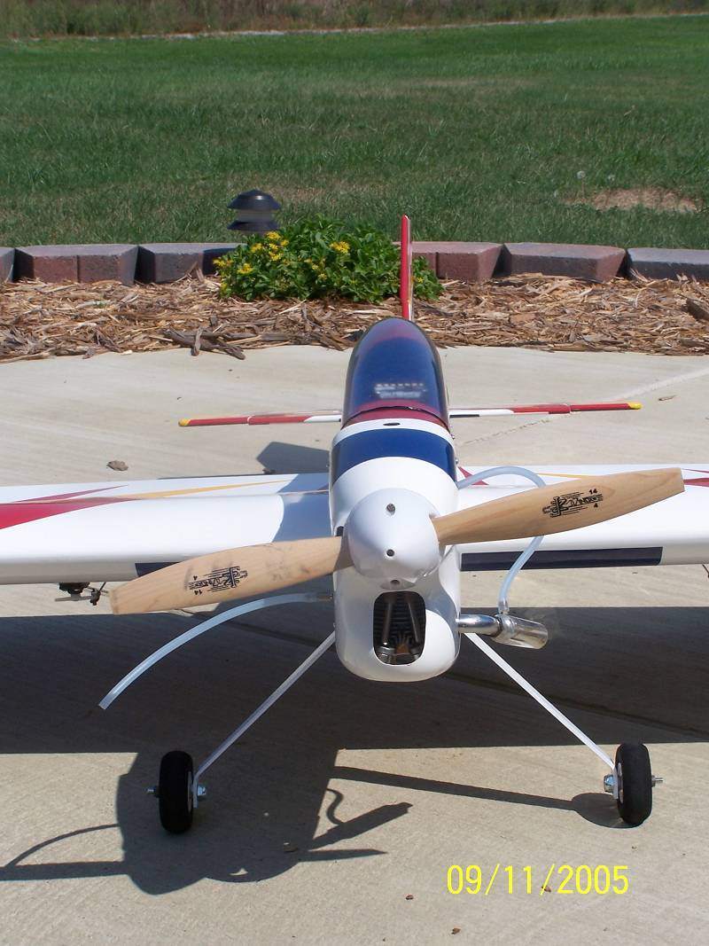

Well here hopefully are Pics of yet another UCAD 46. Wish me luck. Maiden will be Monday weather permitting. Plane final Wt. 6 lbs. 5 oz. with 1100 mah battery, 80 Saito, pretty much stock hardware. CG 5 3/8". Does sound about right.

sounds good Doug, thats exactly what mine weighs with saito 100 and 1100 ma only i have my cg at 5-7/16.
my batt is behind the 2nd former behind wing boltdown.yours will fly great where it is, these have a wide cg area.
did you get your radio figured out? hope so!!
let us know how it goes tomorrow
almost forgot but nice plane pics

Another nice looking U Can Do. Good luck on your maiden. We'll be pulling for ya. You are really going to be pleased with this airplane, I'll bet. They are sweet. At that weight you may want gjeffer or raideron's power. But if your elevation is below 3000' you'll be fine.

There are 5 UCDs at my field also. Unfortunately they are all mine and I only have one now.
Barry
PS: Some of your weight is in the engine. The 82 only weighs 16 ozs.

Barry What are your old UCDs buried at the field? Good point on the Saito 82. Never noticed the wt. difference before. If I had put the 82 on, battery could have been moved up a bunch. Wish I had an 82. It was a choice between 65 or 80.

Plane looks Great Doug!! Let us know how it went...

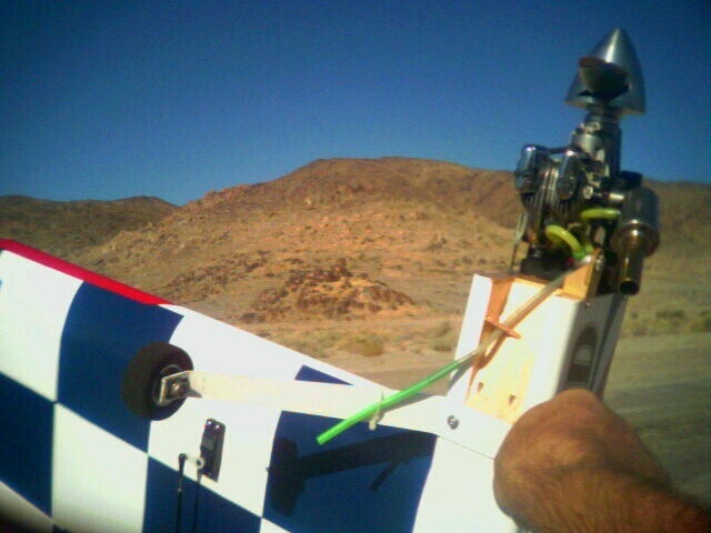

hey guys, just something i did that worked out real well.
i glued a triangle piece of wood with a hole the size of my vent tubing and ran the tubing down to my lg and i now have almost, and i mean almost noooo oil on my plane after 6 flights, making cleanup quick and easyi will use one piece of tubing when i get a piece long enough

Gary... Looks good... Funny you should post this now... But until I get the "Do"
put back together I put the 100 in the 4*60 and have been flying it and the
profile, Anyway on Sat. I was telling some at the field how I love the way the
Saito has been running, But hate all the oil that comes out the vent and all on
the bottom of the plane and one of the guys there said to do the same as you've
done except in just drilled a hole for the tube in the L.G.... I'll do that on the "Do"
but will leave the 4* as is... The Mag is very clean:-)..... Have a Great One!!

Gary great idea. Wish I had thought to put tubing on vent before mounting engine. Not sure I can get it on without removing engine.

Hey Gary, Thanks for the tip. I'll have to try that. Yee Gads!! Look at the size of that motor. [X(] Man! Where did you get that from? NASA? [X(]
