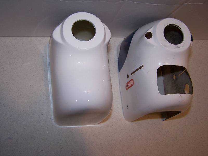

Nitro Dew...Another thing I was thinking about if I was building a UCD for the first time. Air flow. Especially with a 4 stroke engine. You need a great amount of air flow. The first couple I built I didn't get enough air flow through the cowl and they would run fine for 5 minutes or so and then start to load up and run rich. You have to really open the cowl up. On the front and especilly underneath. Here's a picture to kinda help.
Barry

Twice as much out than in is the general rule (?).

Barry,
Thanks for the cowl photos ... will do! Mac also sent me a lot of set up info. I'm feeling much better about getting the UCD together. I just work too much and I 'm slow at getting to the building. Oh well, I've got the winter .... Thanks!
