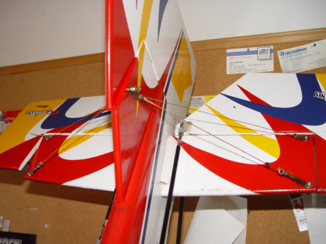

got any pictures of the kevlar set-up?? Can you post them??

Here you go hobby_man. You can also see the triangle stock.
Another thing to think about - I used 4-40 rod to start out with, and I bent them. The carbon rods won't bend or break, might help prevent flutter.
That prop size set off a big alarm!
For a .51 I'd try a 12x4 or 12.25x3.75.

The picture of your handy work looks great, Thanks.
Did you make your rods or buy them somewhere??

Actually they're not rods, it's kevlar string. Will not stretch, and pretty strong. It will fray from the vibration though, so I put a drop of CA on the kevlar where it loops through the eyelets.
Everything needed to do what I did comes in Sullivan's flying wire kit. I don't know the part number. The kit was 16 bucks at my LHS. It also includes steel wire, but I didn't feel like putting a potential source of interference on the tail.
