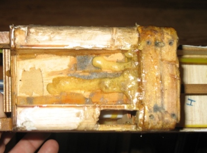

Hi guys!
I just recoverd a ucando .46 which for the most is in good shape. No electronics or engine came with it. I have a super tigre .75 but I am not sure if it is going to be and over or under kill. as far as servos can I uso the standard servos or should I use torque? The previous owner did an oufull fix on the LG section and I need some suggestions on how to get it fixed. (My first garbage can fix)

Hi cjposada... Standard servos of 50#/oz will work good, I'm running HS 425BB's on 6v, I
do have a stronger one on the rudder... Kinda hard to tell if the bulsa is fuel soaked?? if
so you may need a little more work on the L.G. block/area.. But if it's not, you can clean
up the excess glue re sheet the hole and on the L.G. block most just drill holes from the
wing bulkhead through the L.G. block and out the tunnel, then epoxy in screws or I used
2 440 rods, it works great.. The 75, might be a bit heavy, (plenty of power) but should
work as long as the firewall is in good shape...,(But I don't know much about that engine)
some including me have had the S-100 4c in the nose with no problems Good luck
You can see a pic on the screw or 440rods on page 206 post 5150

cjposada that plane use to be mine.lol.........sorry about the "awfull" repair on landing gear im only 12years old and I have no help at home to fix my planes. Also the balsa is not fuelsoaked. even though it looks "awfull" its pretty strong. I sold the plane with an o.s 61fx and standard servos. I dont know if i sold it to you but that use to be my plane lol..... The O.S 61fx had alot of power for that plane but a better engine is saito .82 4-stroke.

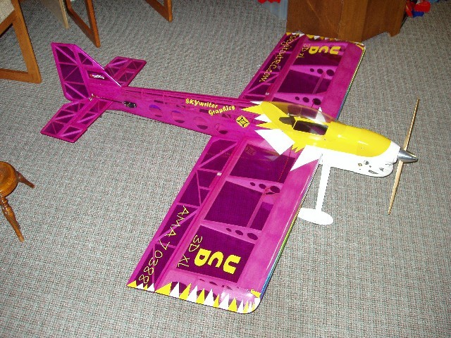

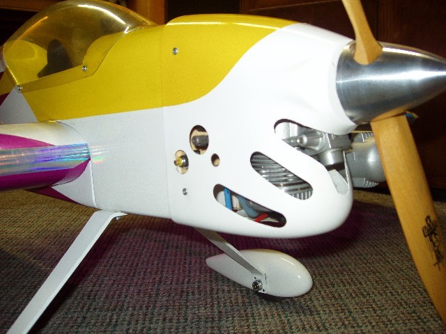

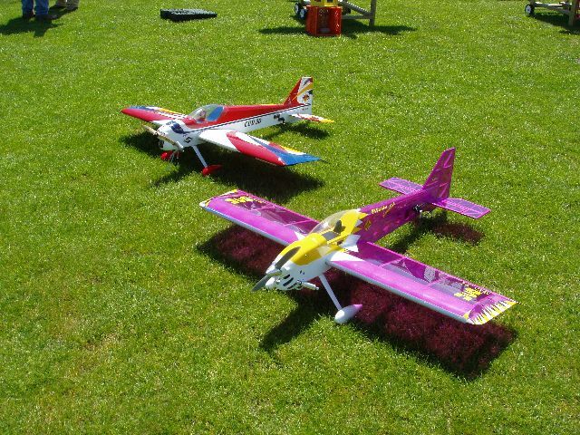

This is my UCD 46, was recovered from day one. Wanted to use a lighter covering, H9 Transparent LITES Violet 968. I did this before the “Harrier†came out. Had a OS 70 Surpass. Changed it to a OS 91 FX, 16 x 5 prop and CG at 6 inches. Had to add 4 oz of lead to tail. Great even in the wind. Much better down low. I LOVE IT!

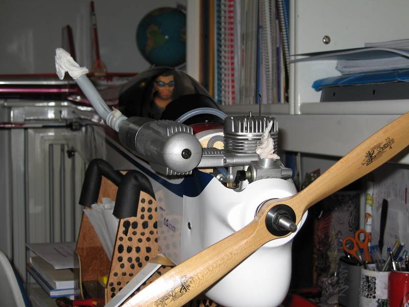

I have the UCD 46 and the OS 91 FX in it.
Prop is a Zinger 15x4 and it rocks.[X(][X(]

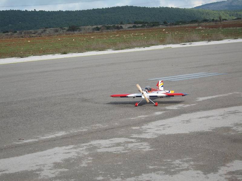

Kostas1 Nice flying site looks like an airport runway? I see you mounted your OS 91 upright, are you using a pump?

No it's a flying field!
It's a 100meters long and 25meters wide.
No,
i don't use a pump.
My OS 91FX is mounted upright.
It runs like a champ.
Prop is an Zinger 15x4.
It hovers at 1/3 of the throttle travel.
Do you like it?

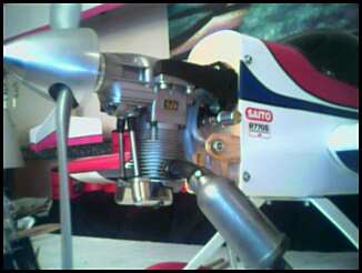

[X(]

It should be just enough power! My Saito 82 with 14x4 rock, this should be fun!

gjeffers...
Whoaaaaaaaaaaaaa!?!?!?!?!?!? What are you thinking. Be sure to use throttle management. I can't even imagine what that thing will be like.
Good luck.

Hey Gary, How come you put that whimpy little thing on there.........[>:] You could have installed a YS 140......

HEE HEE HAW!!
ive had to put new bearings in the 100 so it was just sitting up there on the shelf and i couldnt help it
i already took it out and flew it and it really balances great at 5" and does great FS andactually helped on the knife by reducing my ele mix in half
but as all great things come to an end this shall too, got my bearings in last night and will change back soon..
when they say that the 125 and 100 have the sane mounting dimensions they are nnot lying, just had to adjust the throttle a little
does have good vertical............at half throttle

Hey Gary.... Talk about not having to move the stick S125 )...... Ya a hungry man!!
Ahh ??? Is that on a different 100???
